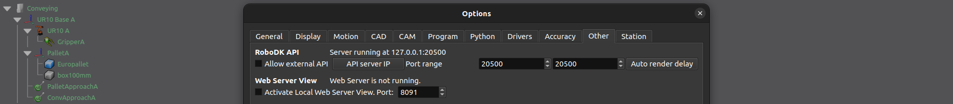

However, although 3 RDKs corresponding to ports (20501, 20502, 20503) should have been started, 3 projects are added to the RDK corresponding to port (20500) which should not be used. I want to fix this bug.
In the code below three RDKs were created.
NUM_WORKERS = 3
robodk_executable_path = "/home/***/RoboDK/RoboDK-Start.sh"
for env_no in range(1, NUM_WORKERS+1):
   api_port = 20500 + env_no
   subprocess.Popen(["bash", robodk_executable_path, "-NEWINSTANCE", "-PORT", str(api_port)], stdout=subprocess.DEVNULL, stderr=subprocess.DEVNULL)
Next, I planned to add projects to each RDK with the code below, but all projects were added to the RDK of port (20500) which should not exist.

#12
You should better use the port parameter available on the constructor. Example:
RDK = Robolink(port=20503)
This will make sure the Robolink instance also uses this port.
The port is also an environment variable set by RoboDK as ROBODK_API_PORT when a Python script is executed by RoboDK. This is handled automatically when this environment variable exists.

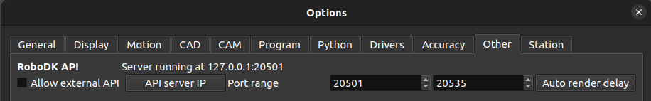

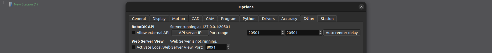

#14
(07-24-2023, 05:25 PM)Albert Wrote: You should better use the port parameter available on the constructor. Example:
I thought I could start multiple RoboDKs by specifying the port. However, it seems that ports are assigned in the order RoboDK is started. By changing the starting number of "Port range" from '20500' to '20501' as attached, multiple RoboDKs were assigned ports '20501 to 20503'.
#15
The -PORT argument is required when starting RoboDK if you want to specify the port. However, when you start RoboDK from the API it is better to use the port argument so the client API and RoboDK are both using the same port.
If you change the port range settings it allows each instance of RoboDK to use a different port. This port will be used by Python scripts triggered from RoboDK.
#16
(07-25-2023, 07:50 AM)Albert Wrote: The -PORT argument is required when starting RoboDK if you want to specify the port. However, when you start RoboDK from the API it is better to use the port argument so the client API and RoboDK are both using the same port.

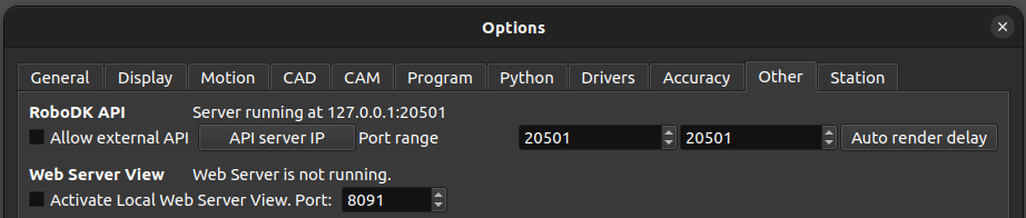

jellyfish:$ sh /home/ddpg7/RoboDK/RoboDK-Start.sh
API Server Port set to  20503
Trying to run arguments on running instance... ("-PORT=20503")
No running instances of RoboDK detected
Starting  RoboDK  v 5.6.0 . 23250  ...
OS:  LIN64
Date build:  Apr  8 2023
Main process ID:  12501
Thread ID:  0x7fb53ce14a00
Processing event...
Starting RobotTools...
Loading settings...
Setting up default settings...
Default settings set
Reading saved settings...
Settings loaded
Statusbar:  "Language set to English"
Updating recent files menu...
Created language menu
Setting slider style...
Done
Setting up graphics...
Setting up main window...
Starting main window...
Statusbar:  "Loaded 0 plugins"
Reading preferred layout settings...
Done
Closing splash window
Initializing OpenGL...
Initializing OpenGL Functions...
Initializing OpenGL Shaders...
Loading vertex 1
Loading fragment 1
Loading vertex 2
Loading fragment 2
Loading texture vertex 1
Loading texture fragment 1
Shader pointers:
0   1   2   1   0
0   1   2   1   0
3   4   5
0   2   1   0
0   1
OpenGL Ready
Updating window title...
Entering main loop
Running arguments...
Running parameter:  "-PORT=20503"
EXECUTING:"-PORT=20503":...
-PORT=20503:"-1"
Starting RoboDK API Server
Silent message:  "Server is running at localhost:20503"
RoboDK API status:  Server is running at localhost:20503
RoboDK is Running...
But the documentation has space characters on both ends of the '='. I'd better change that.
I think there are people who are addicted to it.

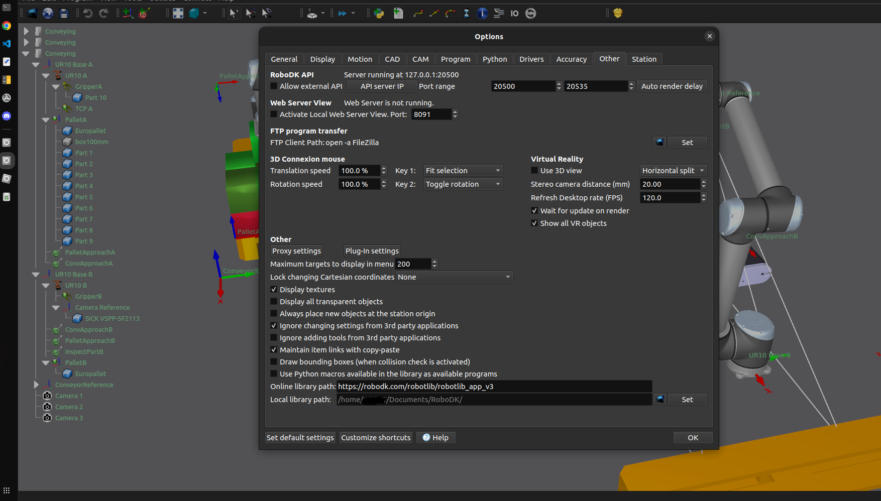

Next is another problem.
Above, I was able to start RoboDK even if the port number was not '20500'.
However, if the port number is other than '20500', the "RDK.AddFile()" method throws an error and fails to load the '.rdk' file into the project.
-For port:20500
New connection from:  QHostAddress("127.0.0.1") : 36416
API client says hello:  "RDK_API"
Running API Command:  "Add"
Loading file:  "/home/ddpg7/ws/robodk/conveying/./rdk/Conveying.rdk"
Statusbar:  "Loading: /home/ddpg7/ws/robodk/conveying/./rdk/Conveying.rdk"
Using temporary file name to load station:  "/tmp/RoboDK.wfeSgr"
Loading:  "/home/ddpg7/ws/robodk/conveying/./rdk/Conveying.rdk"
Version Station File 101
Statusbar:  "Loading finished."
Loading complete
File loaded
Updating positions and rendering...
Done with API Command:  "Add"
Deleted connection:  QTcpSocket(0x55588a4d5e20)
-For port:20501
New connection from:  QHostAddress("127.0.0.1") : 51184
API client says hello:  "CMD_START"
Running API Command:  "ExecArgs"
Running parameter:  "-PORT=20501"
EXECUTING:"-PORT=20501":...
-PORT=20501:"20501"
Done with API Command:  "ExecArgs"
Deleted connection:  QTcpSocket(0x7f0c9c006200)
Here is the test script.
import os
from robodk.robolink import Robolink
ROBODK_ROOT = '/home/ddpg7/RoboDK'
RDK_FILE_PATH = './rdk/Conveying.rdk'
os.chdir(ROBODK_ROOT + '/bin')
LD_LIBRARY_PATH = os.getcwd() + '/lib'
os.environ['LD_LIBRARY_PATH'] = LD_LIBRARY_PATH
QT_PLUGIN_PATH = os.getcwd() + '/plugins/'
os.environ['QT_PLUGIN_PATH'] = QT_PLUGIN_PATH
QT_QPA_PLATFORM_PLUGIN_PATH = os.getcwd() + '/plugins'
os.environ['QT_QPA_PLATFORM_PLUGIN_PATH'] = QT_QPA_PLATFORM_PLUGIN_PATH
# Specify the desired port number
#port = 20500
port = 20501
# Create a Robolink instance and connect to RoboDK on the specified port
RDK = Robolink(args=f"-PORT={port}")
# Load the .rdk file into the RoboDK project
rdk_file_path = "./rdk/Conveying.rdk"
project_directory = os.path.abspath(os.path.dirname(__file__))
project_directory = os.path.join(project_directory, rdk_file_path)
print(f"Opening station: {project_directory}")
station = RDK.AddFile(project_directory)
try:
   RDK.AddFile(rdk_file_path)
except Exception as e:
   print(f"Failed to RDK.AddFile: {e}")
RodoDK is starting from terminal.
- ./RoboDK -NEWINSTANCE -PORT=20500
- ./RoboDK -NEWINSTANCE -PORT=20501
Screenshot from 2023-07-28 09-49-38.png    Screenshot from 2023-07-28 09-48-01.png    Screenshot from 2023-07-28 10-08-01.png
