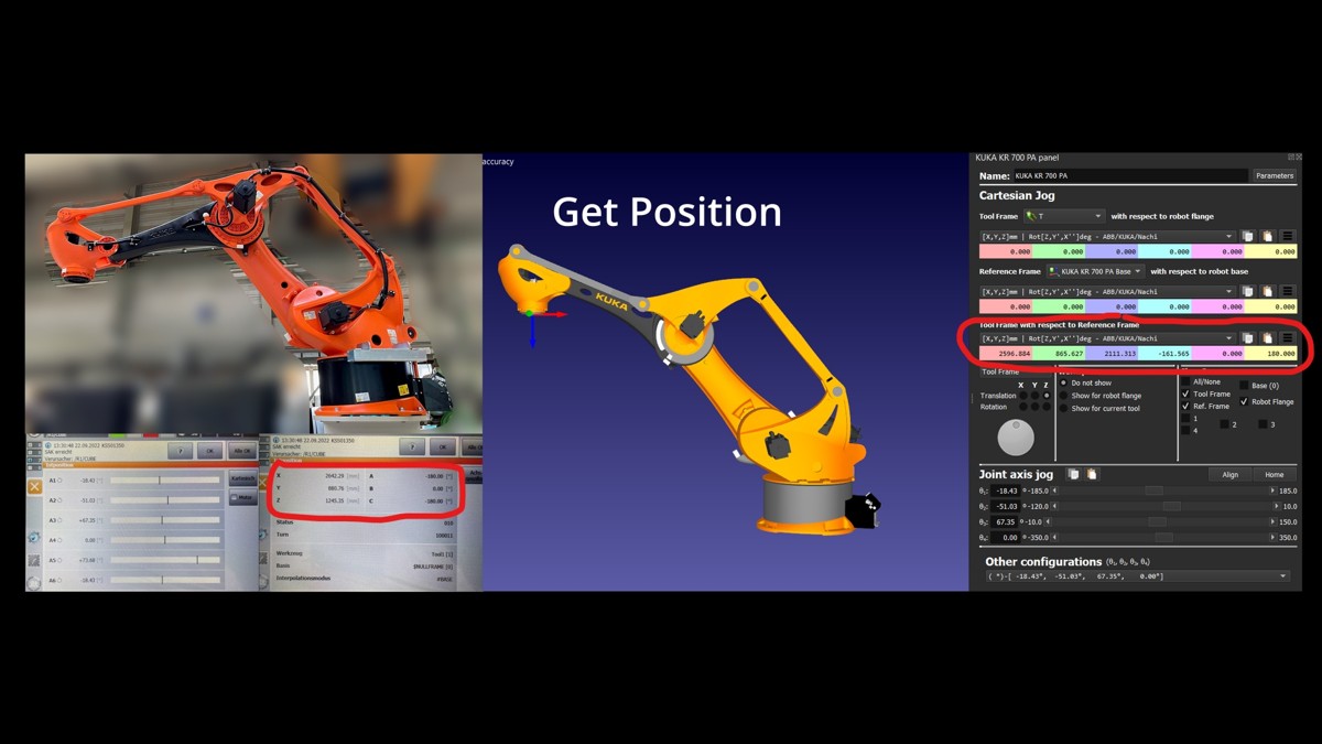

  • When using "Get Position", the coordinates of the simulated robot differ from the actual coordinates (see attachment "get_position.jpg"). The joint angles are the same, but the position does not look the same. I am certain that our actual robot is installed correctly.

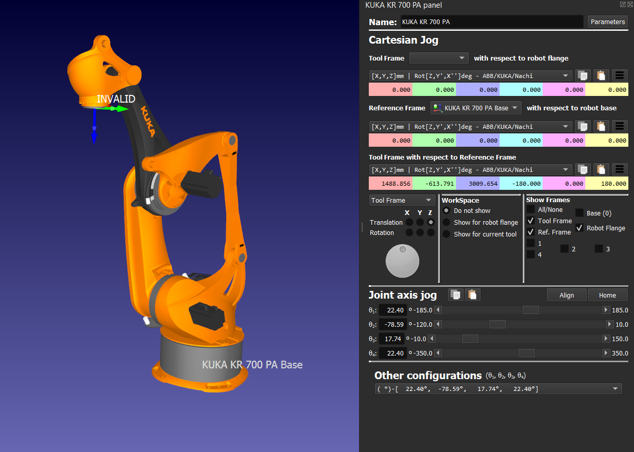

I noticed that the new model can be moved to invalid positions (see attached image).

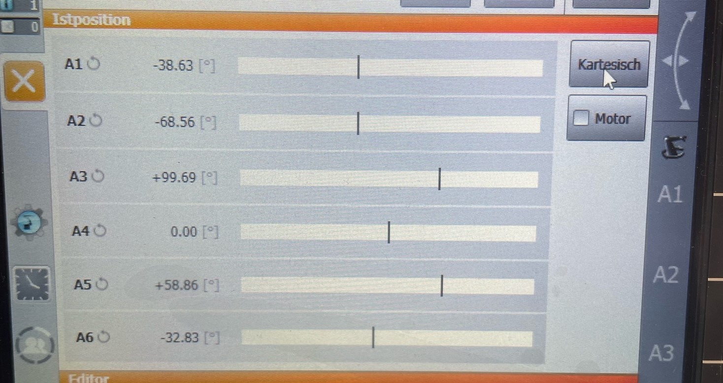

For clarification: "Actual" represents the values read from the controller's smartPad and "RoboDK (get)" describes the values shown in the RoboDK GUI when using "Get Position". "RoboDK (send)" is what has been sent in the TCP packet from RoboDK to the controller via "Move Joints" for the position that has just been retrieved. The positions can be viewed in the attached rdk-file.
As mentioned before, it seems like RoboDK sends X and Y coordinates instead of A5 and A6 joint angles to the controller and sets the received A4 angle as the flange (A6). I believe it is necessary to process the entire array of A1-A6 in RoboDK, since the controller expects the passive joints to be set correctly. When sending positions from RoboDK to the controller, I noticed they mostly fail because a software limit switch is reached for A5.
