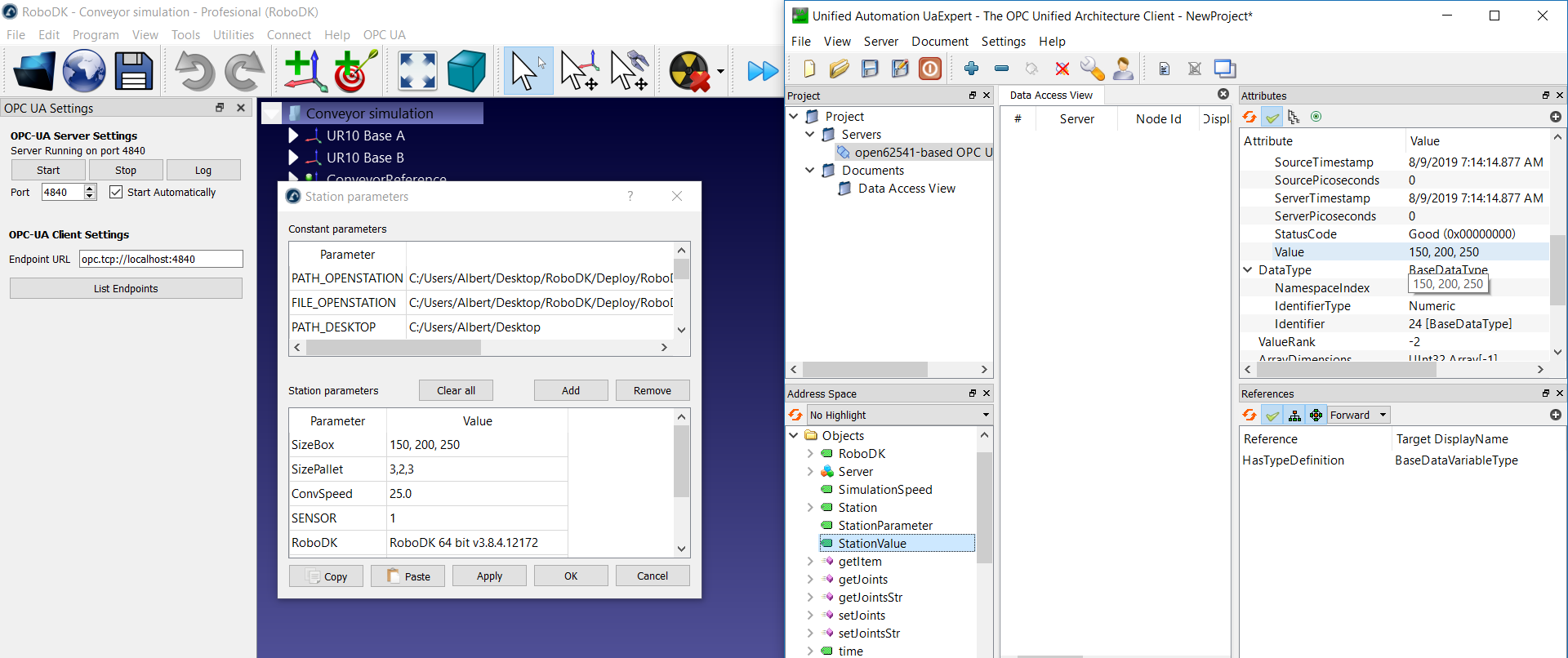

Among other things, RoboDK's OPC-UA server exposes access to station parameters by using the nodes StationParameter and StationValue. You can set the station parameter you want to see or modify in StationParameter field and view/modify the value using StationValue. You can also retrieve items by name (like you can do with the API) and retrieve or update the position of robots and mechanisms.
You'll find the station parameters by right clicking the station root and selecting "Station Parameters". When you use Inputs and Outputs some IO parameters are automatically created and updated.

So when I activate the plug in and start the server I can access it with UA Expert client.
But how do I have to enter the parameters in the station.
You explained, that if I want to access objects, robots or anything else from the station, that it is similar to the python method.
So I opened the station parameters and tried several different options but none did work
Can you please give an example on how to set the parameters for accessing the joints of a robot...
