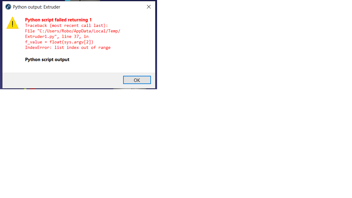

The script reports an error
How to output information about the variable extruder speed and the amount of filament
#14
How do I assign the SPEED_MS variable to sys.argv [2] ??
Self.PRINT_E_NEW is assigned to sys.argv [1]
I want to read these two variables with sparks
import sys
if len(sys.argv) > 1:
   E_Value = float(sys.argv[1])
mport sys
if len(sys.argv) > 2:
  e_value = float(sys.argv[2])
if f_value is None :
f_value = 0
I can't pass SPEED_MS to extuder speed I want to send two parameters, speed and quantity of filamant
Thank you
