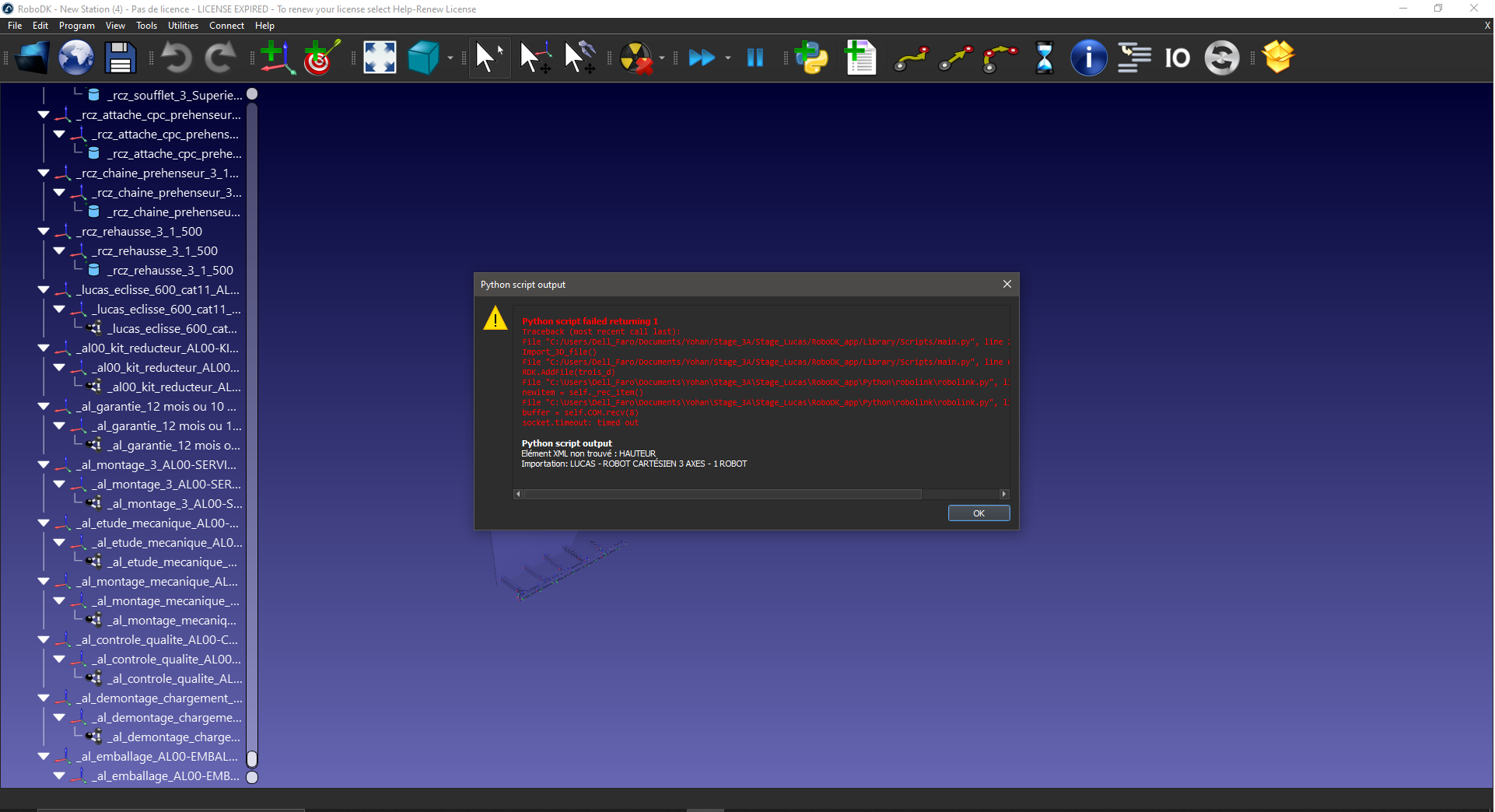

Timeout exception when loading a 3D STEP file
A Timeout exception raises when I load a big step file as assembly with the RDK.AddFile() function.
I would like to know if there is a way to avoid this error?

Bonjour Yohan,
There's a timer TIMEOUT timer somewhere in the RoboDK python libraries (robolink.py and robodk.py) and that needs to be changed, but I can't remember which one.
I will ask, and get back to you.
At some point, I found it on my own by "ctrl+f" my way through the files, but I don't remember exactly.
Rebonjour Yohan,
RDK.COM.settimeout(RDK.TIMEOUT)
Bonjour Jeremy,
Thanks for your answer, I raised the timeout by setting 120 seconds, it should be enough.
