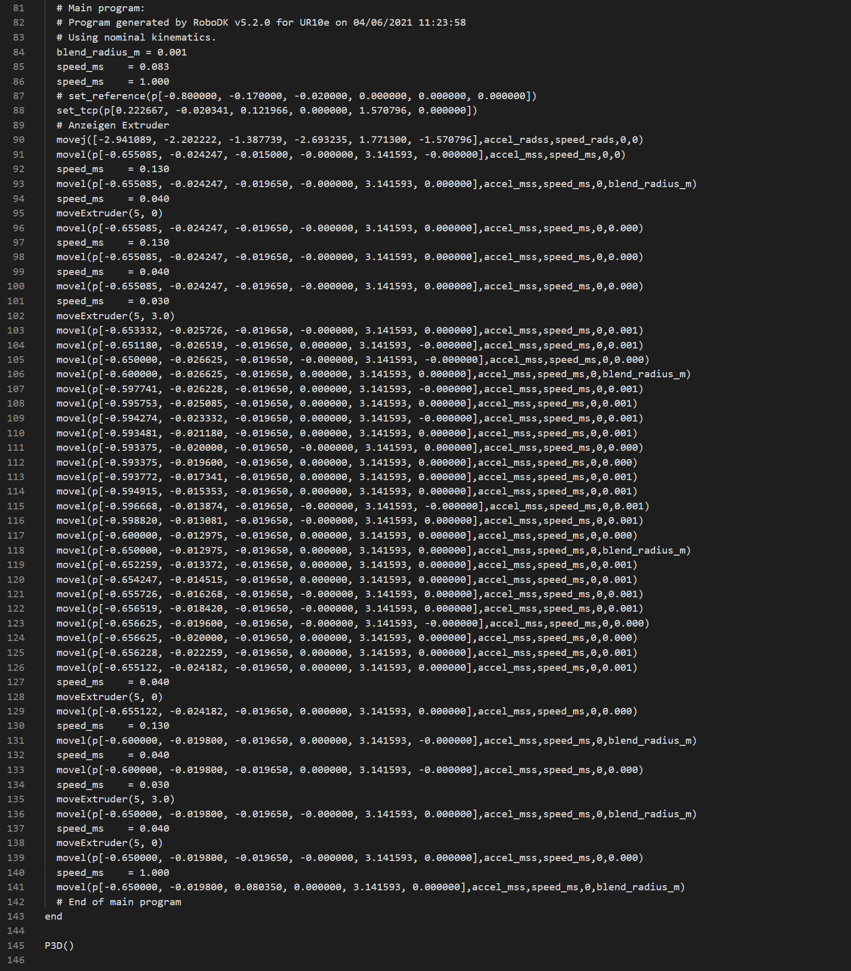

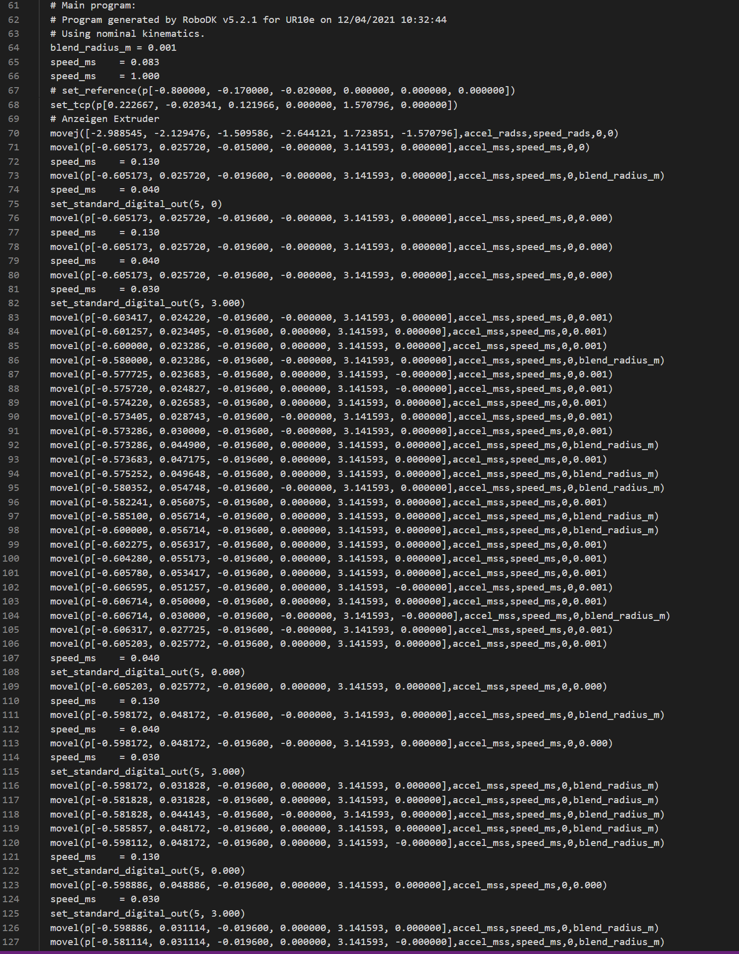

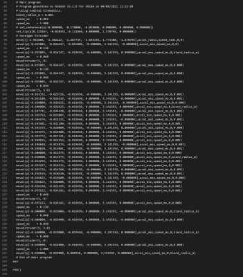

#14
(06-04-2021, 12:20 PM)Kosiahn Wrote: Hello,
could you explain to me the difference between .script file and .urp file?
After saving the program in RoboDK, I noticed while working with the robot that the code in the scipt is not as detailed as in the urp file. In addition, the information contained is not identical.
Best regards
J. Kosiahn
The picture with the 145 lines of code is the program from the script file the other picture is an extract from the program that was created from the URP file.
#15
Both files you sent me are .script files. None of those are URP.
Both UR post-processor (normal and URP) should generate the same program but in a different format.
I will need a bit more information on how you generated those files. Do you have the .rdk file?
