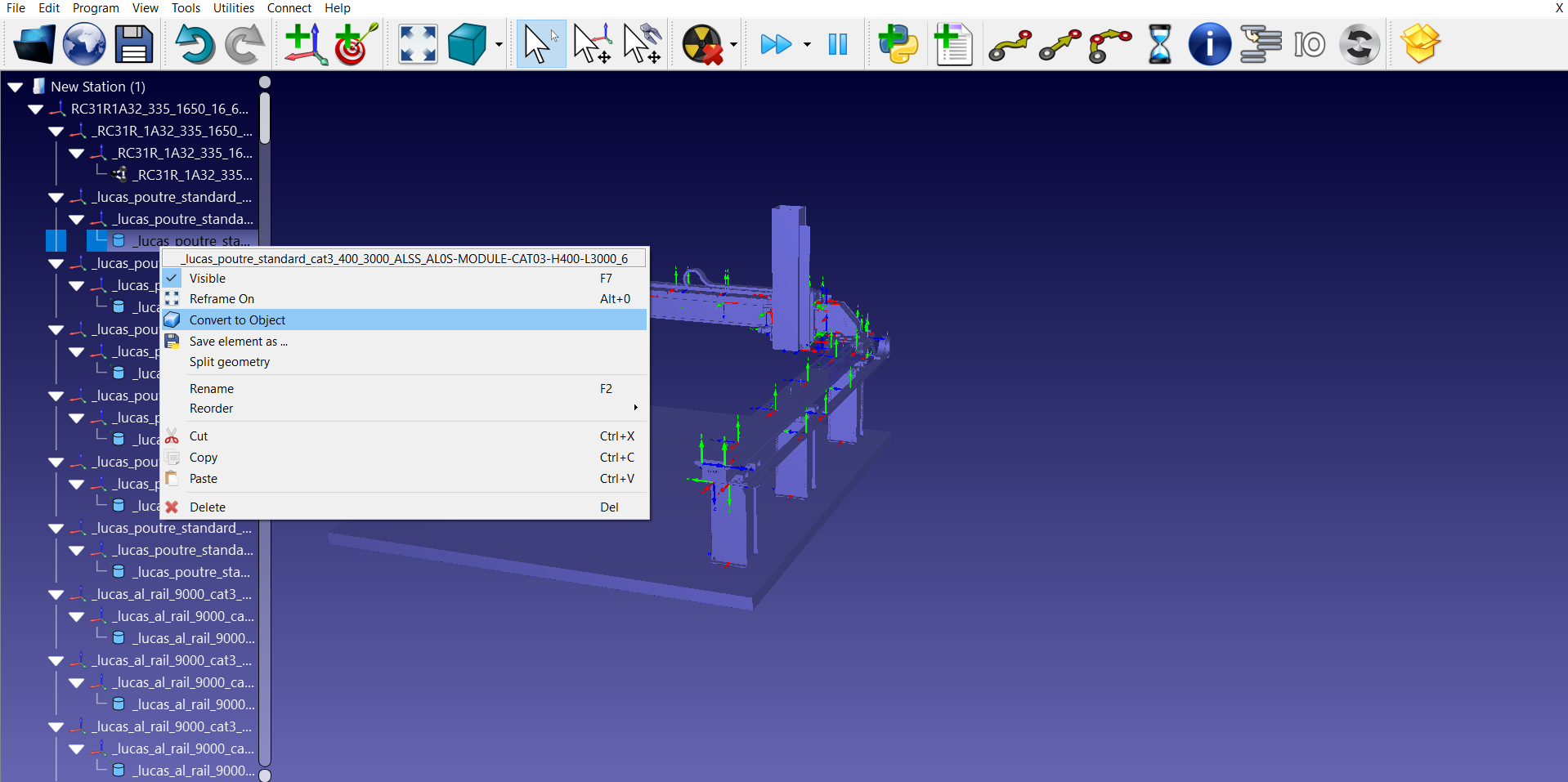

Hello everyone,
I'm working on a project using the Python API, I would like to know if it's possible for you to create a function in the robolink module that converts an item to an object item as shown in the picture attached. It would help me a lot to continue my project! :)

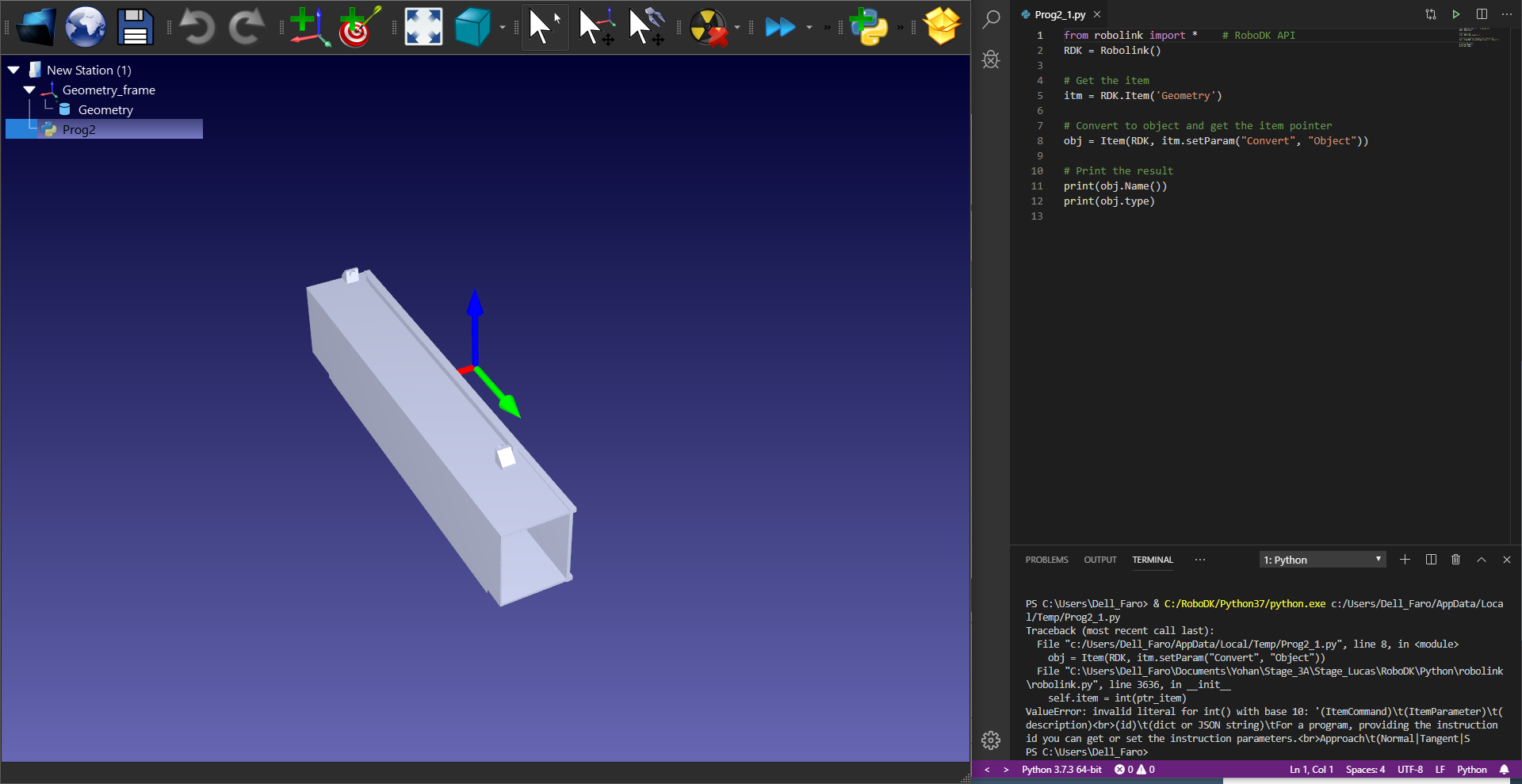

Hi Albert,
Thank you for taking my request into account. I have tested your code example, however I have an error appearing and I don't know where it came from. I have checked and I do have the latest RoboDK v5.2.3 version. Could you help me?

Hi Yohan,
Did you update to 5.2.3 on May 25th or on May 26th?
Because we pushed two 5.2.3 updates this week including the latest with your requested improvements:

Hi Jeremy,
I reinstalled RoboDK to be sure to be up to date, and now the conversion is working well!
