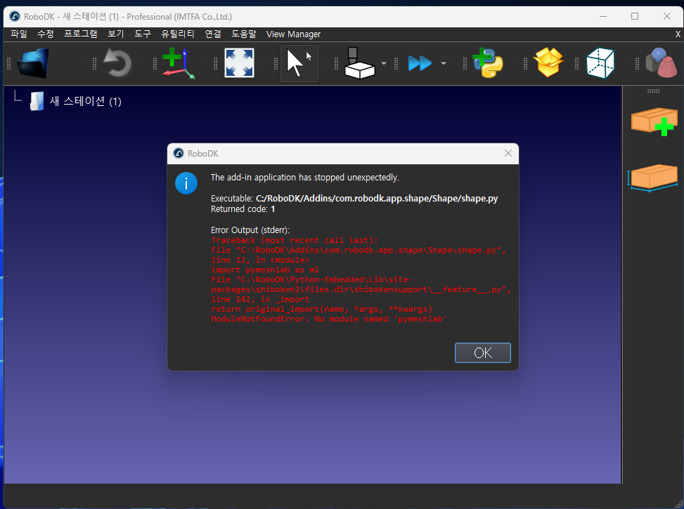

Dear RoboDK experts!
Added shape function. However, when I run it, an error appears as shown in the attached photo. What should I do?
It looks like the pymeshlab module was not installed properly when installing the Shape add-in. You can try to reinstall the addin here:

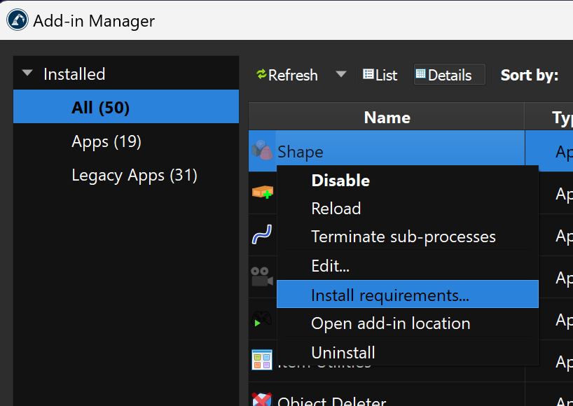

If it still fails, you can try the following to install this required module for the Shape add-in by following these steps:
  1. Make sure you have an internet connection
  2. Select Tools-Add-in manager
  3. Right click on Shape
  4. Select Install Requirements...
You should see a window with some messages about the Python package install progress. This process can take about 2 minutes, depending on your internet connection.

I was able to install it through the add-in manager.
It works well without any problems. Thank you so much for your help!
