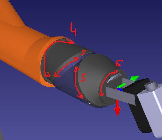

did anybody noticed that the kinematic model of the hollowrist from ABB is wrong?
Please check the attached pictures (robodk and reality)

This is a good catch, we'll try to improve the robot model accordingly and we'll use ABB Robotstudio to check if the kinematics is correct.

We just fixed the kinematics for the ABB IRB 580 robots, including the robot base frame, the tool flange and the motion of joint 6.
I attached the updated versions. We need the 3D models of the new robots you would like us to add. For what I see, there are many different variations of this robot.
For some reason these robots were not in our library but we'll add them in the next few days.
