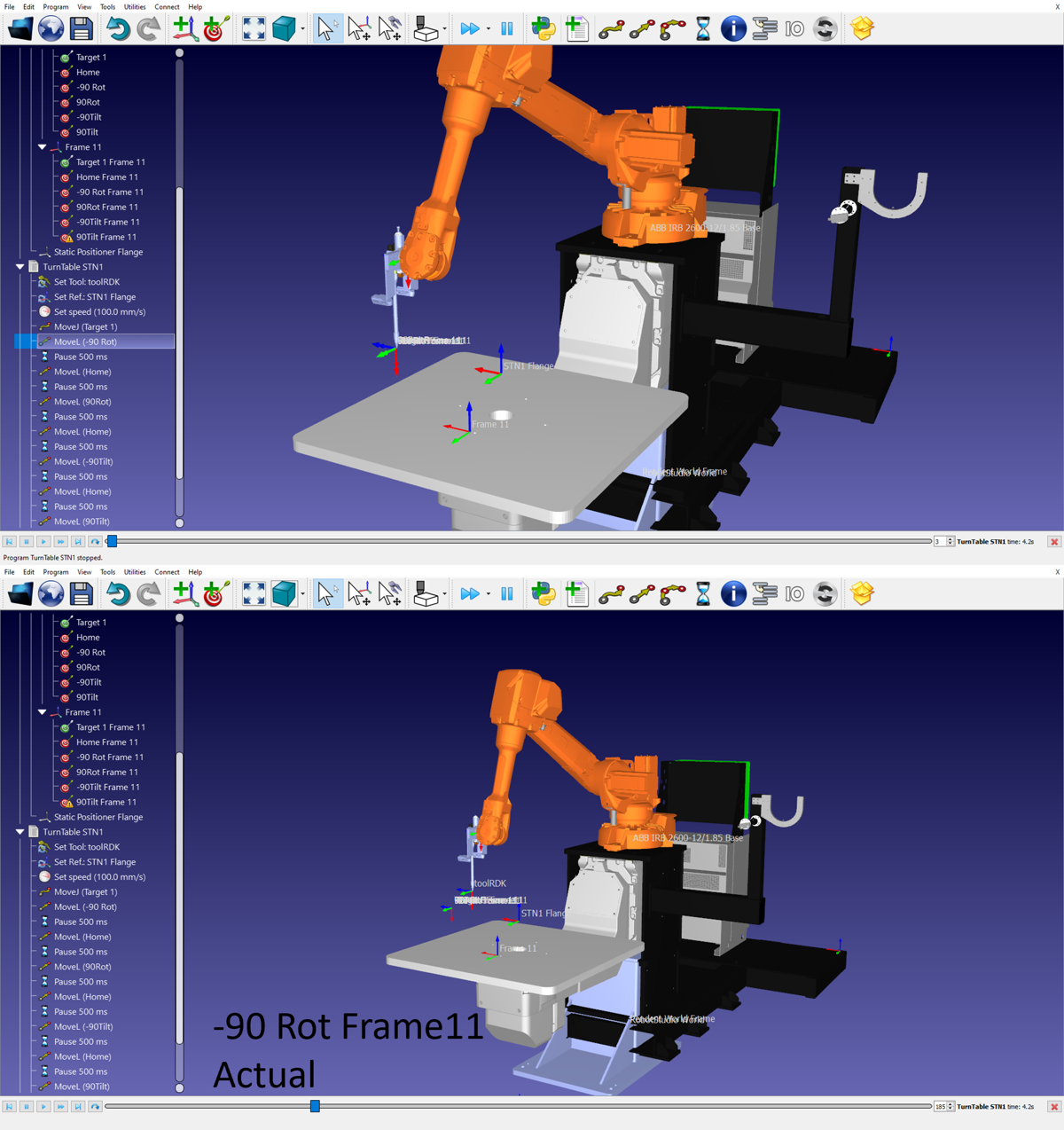

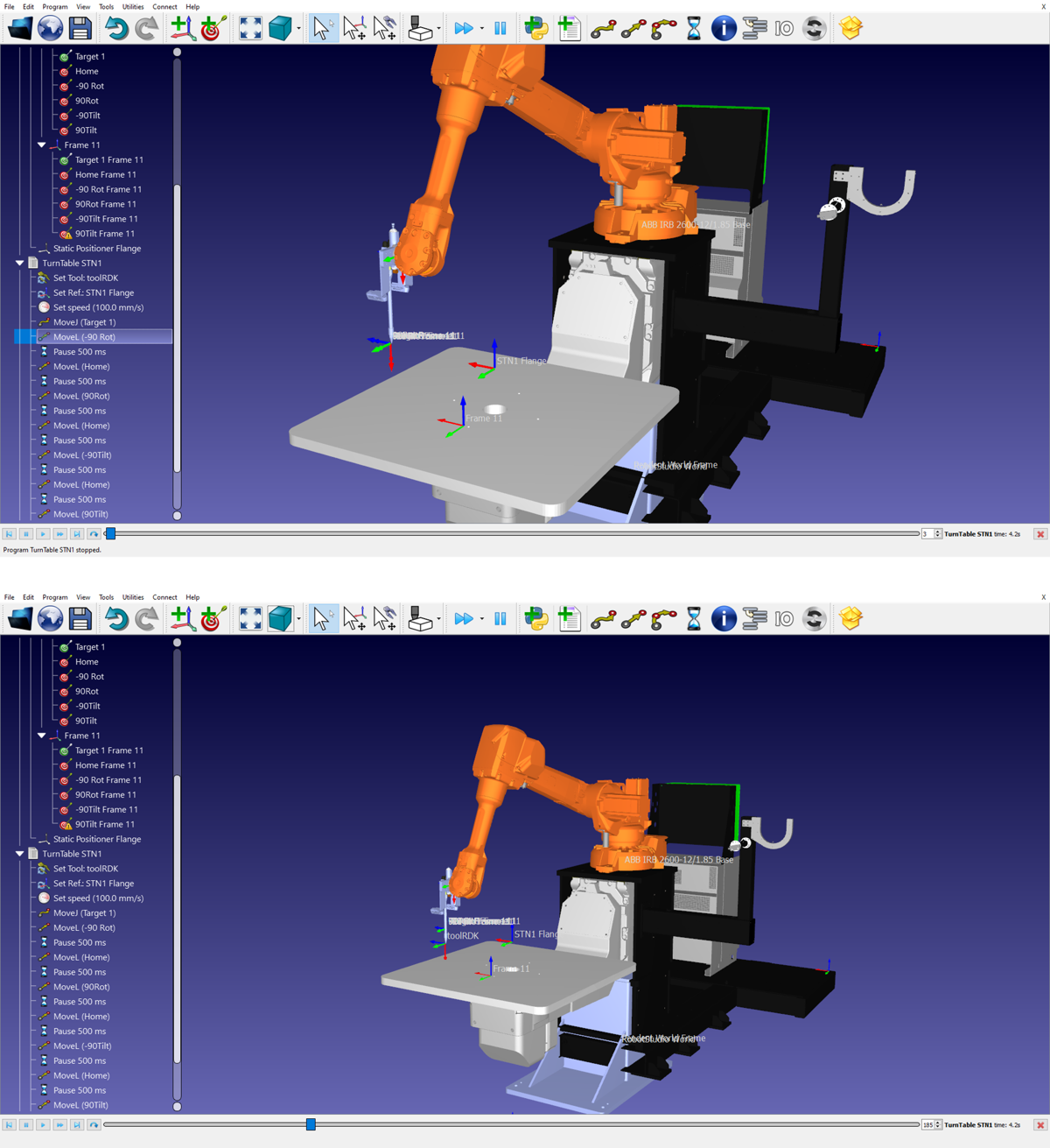

When I run TurnTableSTN1, the robot is close to the desired targets (offset in Y and Z per the MoveL vs MoveJ discrepancy). When I run TurnTableFrame11, the robot misses its targets by approximately the offset defined in the TurnTableFrame11 uframe. When I manually adjust TurnTableFrame11 to put the Frame11 offset from uframe to oframe, it behaves the same as TurnTableSTN1. RoboDK is not outputting the adjustment frames into the oframe as designed. Please advise on how to fix.
shows the -90 rotation of the TurnTableSTN1 program (first MoveL of program) comparing the programmed position (top) to actual position (bottom, read in from controller). Note the significant vertical offset.
shows the -90 rotation of the TurnTableFrame11 program (first MoveL of program) comparing the programmed position (top) to actual position (bottom, read in from controller). Note the significant offset in Y and small offset in Z.
The manually adjust oframe program produces the same result as TurnTableSTN1.
These images show the need to get the oframe set correctly (adjust my RoboDK output) and the MoveL discrepancy of my station (TurnTableSTN1 offset from programmed position).
Please also comment on the discrepancy between the MoveJ and MoveL. I don't understand what frame is misaligned to cause such a discrepancy. The good alignment when running MoveJ suggests the cell is accurately modeled and calibrated, and suggests a frame error somewhere.
