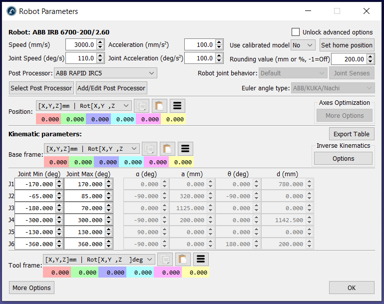

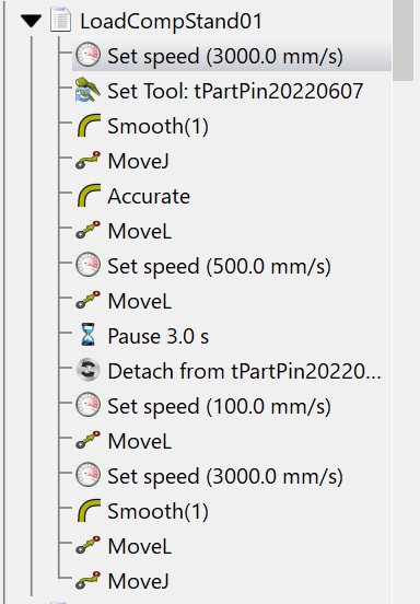

I am currently evaluating RoboDK,
I have a project I did in Robot Studio and thought it would be a good exercise to do the same job in RoboDK and then compare cycle times.
A full cycle in Robot Studio takes 64.5 seconds, whereas I am getting 42.8 seconds in RoboDK. I assume I have not configured the speed and acceleration settings correctly. I will attach a few images of a path and settings.
A question,
The rounding is either on (1) or off (-1)? So it doesn't matter what rounding value I have? I would like a zonedata of z200. Does entering a value greater than "1" have any affect on time or simulation? If I understand correctly from the training videos it doesn't.
Thank you,
Robert
