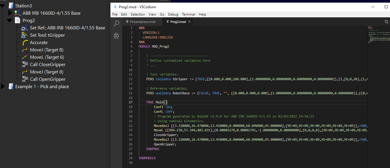

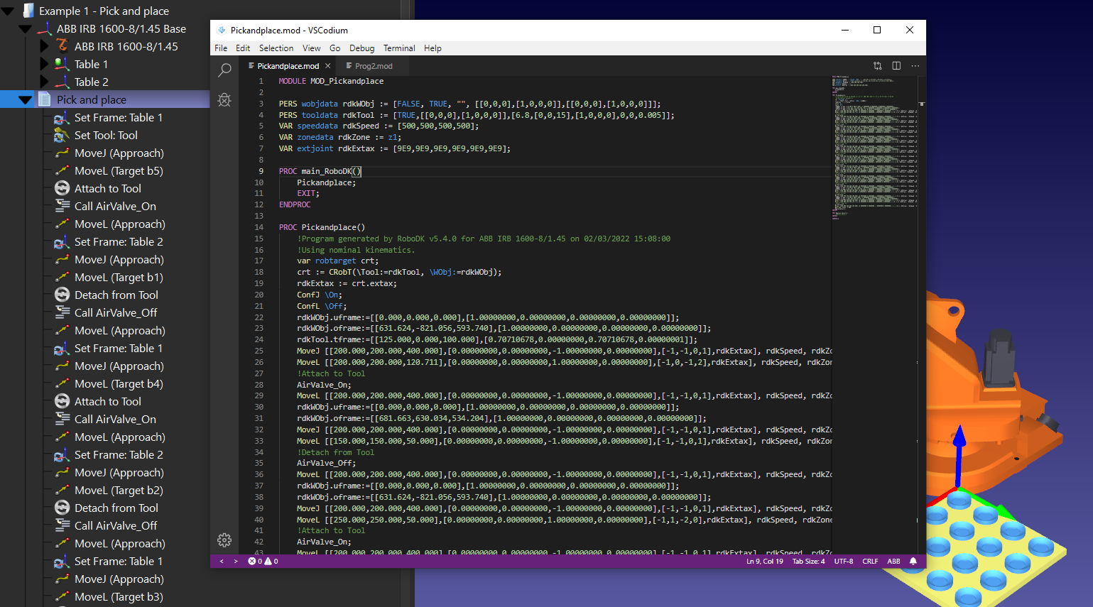

We would like to know how can be change the PROC name from "Main" to "Prog2". If we open the Example 1 - Pick and place, and we generate the program "Pick and place", output file is like:
MODULE MOD_Pickandplace
PROC main_RoboDK()
Pickandplace;
EXIT;
ENDPROC
PROC Pickandplace()
!Program
ENDMODULE
However, when we generate our program, it is generated a file like:
MODULE MOD_Prog2
PROC Main()
ENDMODULE
and we would like to generate something like your example1. We guess that somewhere is an option to change it but we can't find it.
