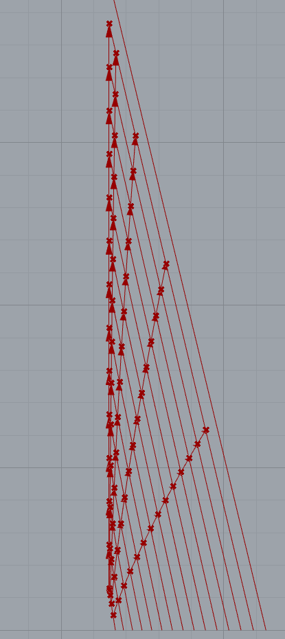

Angle of B axis

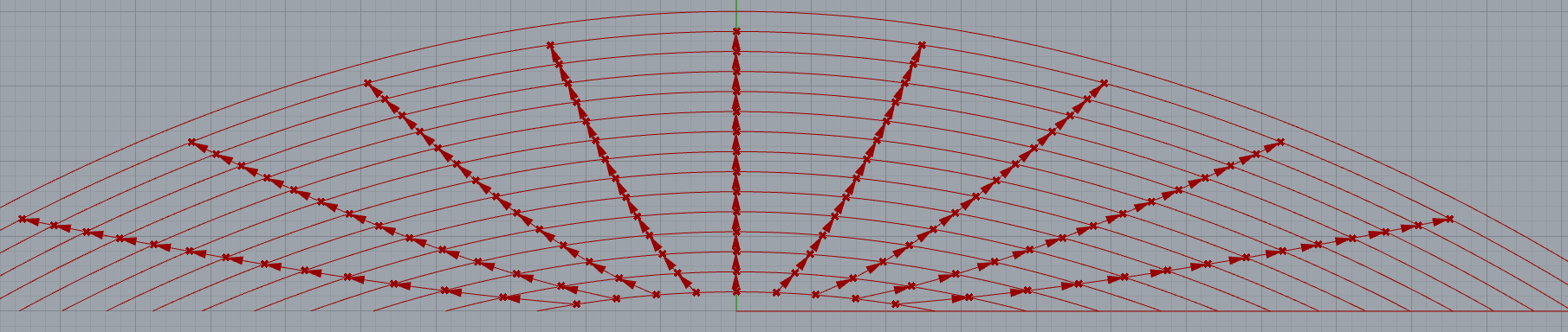

Angle of C axis

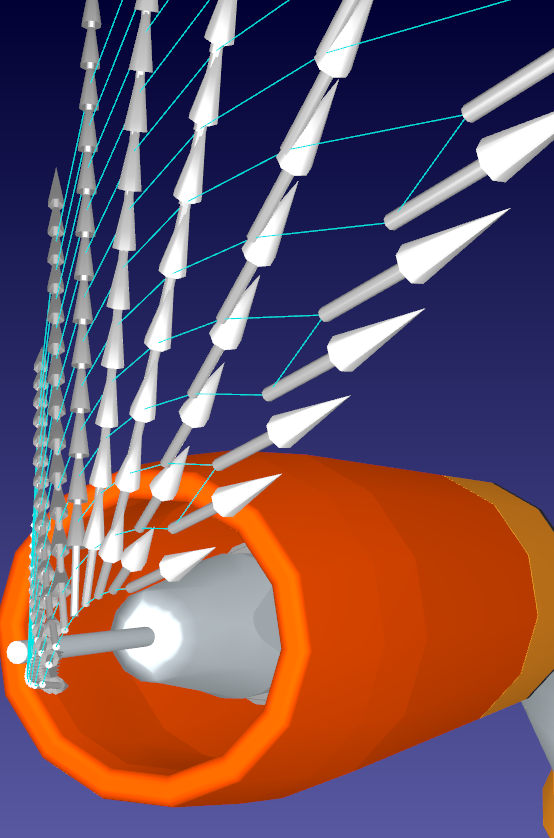

This is what the imported gcode get in Robodk. Angles for B axis is correct, but I am not able to get C axis to work correctly. Cad shows this angle as 31 degree, I can force this to aprox. 10degree and it will be correct in robodk, but I am unable to figure out where I go wrong.
I know the robot crashes in the table as is. I will flip everything 90 degree before welding.

I am using Grasshopper (Rhino that is), and I write out the programs within that environment creating gcode from point to point. XYZ and mostly BC. I use A whenever I have to tilt and rotate the workpiece and weld radial welds
I took a timeout and flipped /rotated the workpiece around in grasshopper, and at a certain rotation I get the correct results. I learned something useful today!
IJK vectors does not translate into gcode nor apt post. But would love some more information about this topic and how to go about it.
I don't use the plugins for rhino/robodk as these do not transfer commands other than movement. And the file2robot plugin needs resetting to update all the time anyway and more important, I feel like I have more control if I do this load nc file manually.
If you can customize program generation using Rhino/Grasshopper then you should not have issues to generate the IJK vector. The IJK vector is simply the Z axis of the tool (what should be the cutting axis). This is a unit vector. You can add the IJK parameters with the current Gcode. The IJK vector is the equivalent of the VZ values you can extract from your pose when using the RoboDK API:
