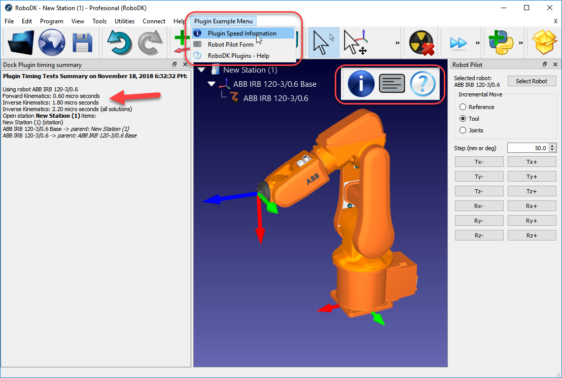

Calculating the inverse kinematics (SolveIK) should be very, very fast (1-50 micro seconds, depending on the robot and the position you request). This function is single threaded so you can't multithread it unless you use a new instance of RoboDK for each calculation (I believe you are already doing that).
You may be experiencing delays due to the overhead of using Python and the API.
If you want very fast results it would be better to use a plugin which directly calls the native C function in RoboDK. Another option is to use the API in another language (using the C or C++ API should be at least 5 times faster than Python).
The main page of the plugin interface page on GitHub shows a specific timing example calculating inverse kinematics for ABB:
https://github.com/RoboDK/Plug-In-Interf...ming-tests
