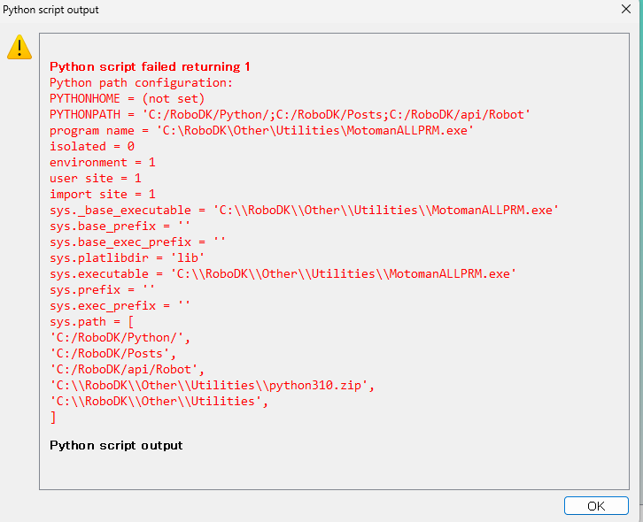

ALL.PRM application failure
When I tried to apply ALL.PRM to the Motoman GA50, I got the error shown in the attached image. Can you tell me how to fix it?

We are looking into this issue.
In the meantime, if you can provide us with the ALL.PRM file and the robot you are trying to use we can load the Pulses/degree data for you.

I attached your Yaskawa Motoman GA50 robot with the correct pluses/degree ratio.
You should be able to properly generate programs with joint targets (pulses) now.
