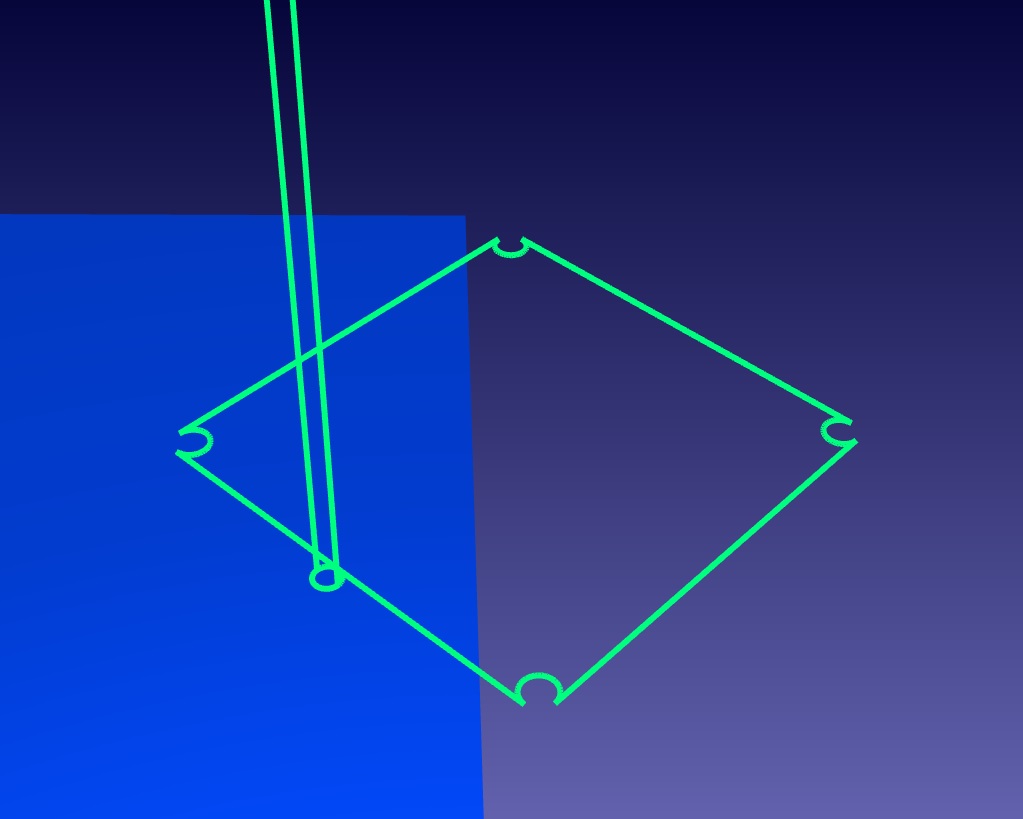

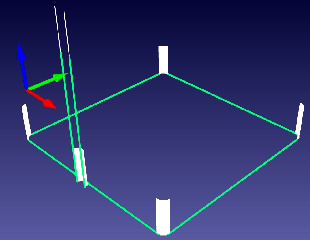

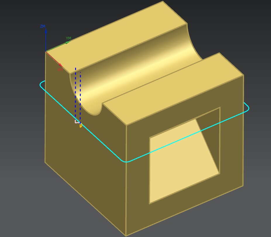

Hello, I have a problem importing nc code.
I export the data from the NX CAM 11 program and then import it into ROBODK. The problem is that robodk imports arcs as inverted. The solution is to manually reverse the vector K in the nc code, but this is not a solution for me because I am creating complex nc codes. I also include test nc code and pictures with this problem.

Thank you for reporting this issue.
This has been fixed with the latest version:
https://robodk.com/download
You should now see the arcs properly.
Let us know if you find any other issues importing APT files.
