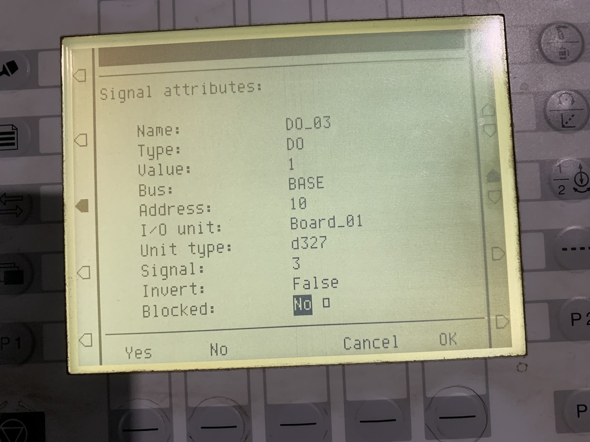

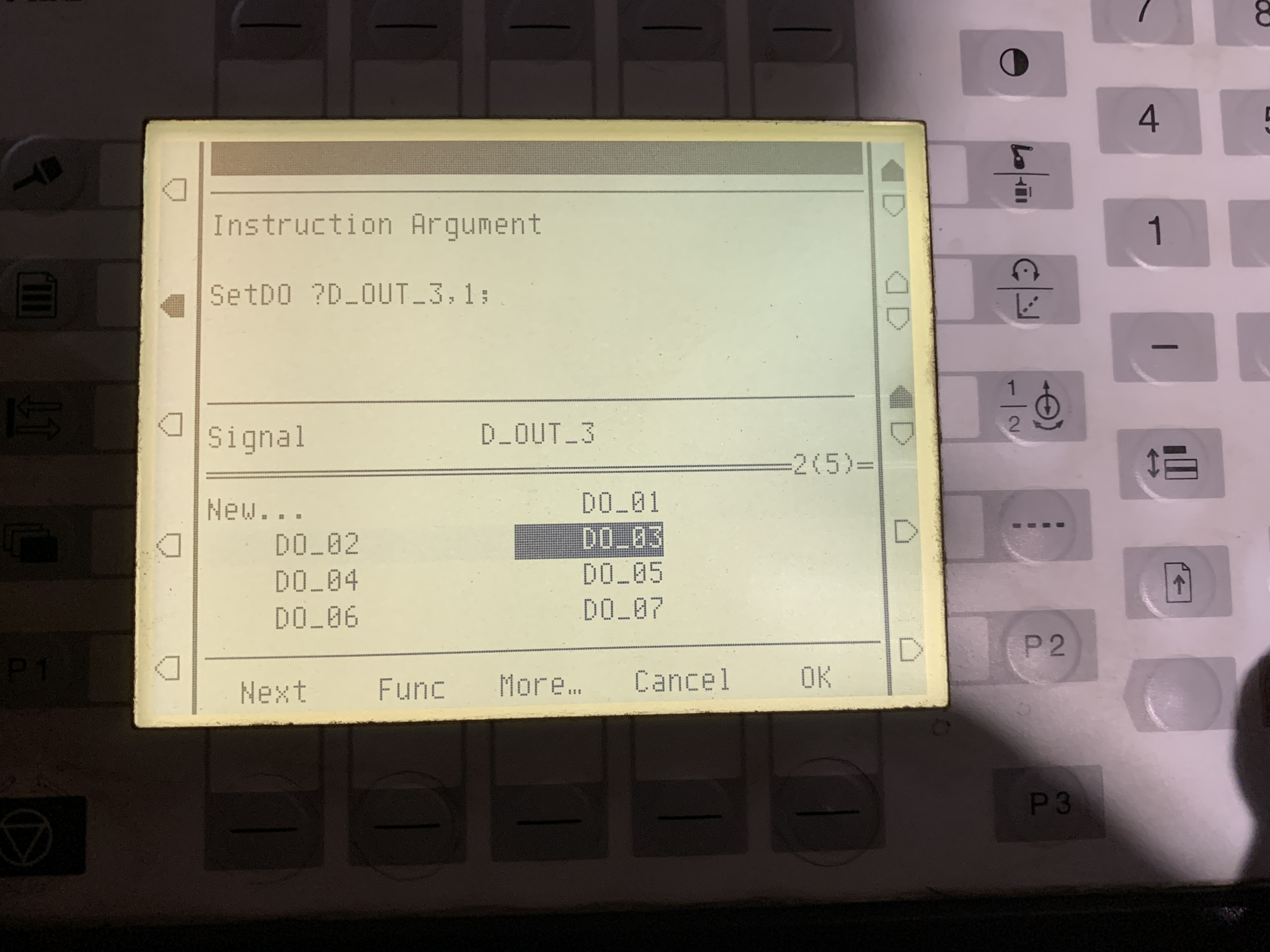

We’re currently having some issues concerning the post processor for an abb s4c+ Controller. The robodk s4c postprocessor now generates
SetDO D_OUT_3 when we load the program the controller want is to change it to DO_03
We have run the program and did a manual replacement of the SetDO D_OUT_3 to DO_03 in visual studio code an that works.
We looked at the base post, but need to go deeper in the post. Obviously we want the postprocessor to do the correction how can we approach the issue here. Can someone elaborate on this!

You can simply override the setDO function inside your RobotPost class by using a function like the one below.
I attached the post processor I believe you need.
class RobotPost(BasePost):
    def setDO(self, io_var, io_value):
        """Set a Digital Output"""
        if type(io_var) != str:  # set default variable name if io_var is a number
            io_var = 'DO_%02i' % io_var
        if type(io_value) != str: # set default variable value if io_value is a number
            if io_value > 0:
                io_value = '1'
            else:
                io_value = '0'
        # at this point, io_var and io_value must be string values
        self.addline('SetDO %s, %s;' % (io_var, io_value))
