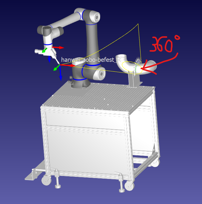

I have a project with a "following path"
When I run the program on RoboDK, the 6th axis does a 360 degree rotation at the beginning of "Weld Path A". Can someone please tell me how to stop this?

I think I found the solution, by selecting "recalculate targets".

Yes, it works now
Great, thank you for letting us know. I understand that selecting Recalculate targets on the targets did the trick.
