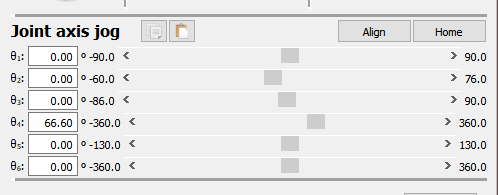

I would imagine if I'm well within joint limits I wouldn't have any issues with the inverse kinematics solver.
For example these joints are well within my robots joint limits, but the inverse kinematic solver fails to find a solution. See attached image for reference on how close this is to the limits.
[0.000000, 0.000000, 0.000000, 66.600000, 0.000000, 0.000000]

Lastly, I'm working with folks to get you a station with one of our calibrated robots. We have some proprietary information that would like to not disclose.
The issue you are referring to in your last example is happening because you are very close to a singularity (joint 5 is zero). Which will have a behavior similar to calculating the inverse kinematics near the joint limits.
