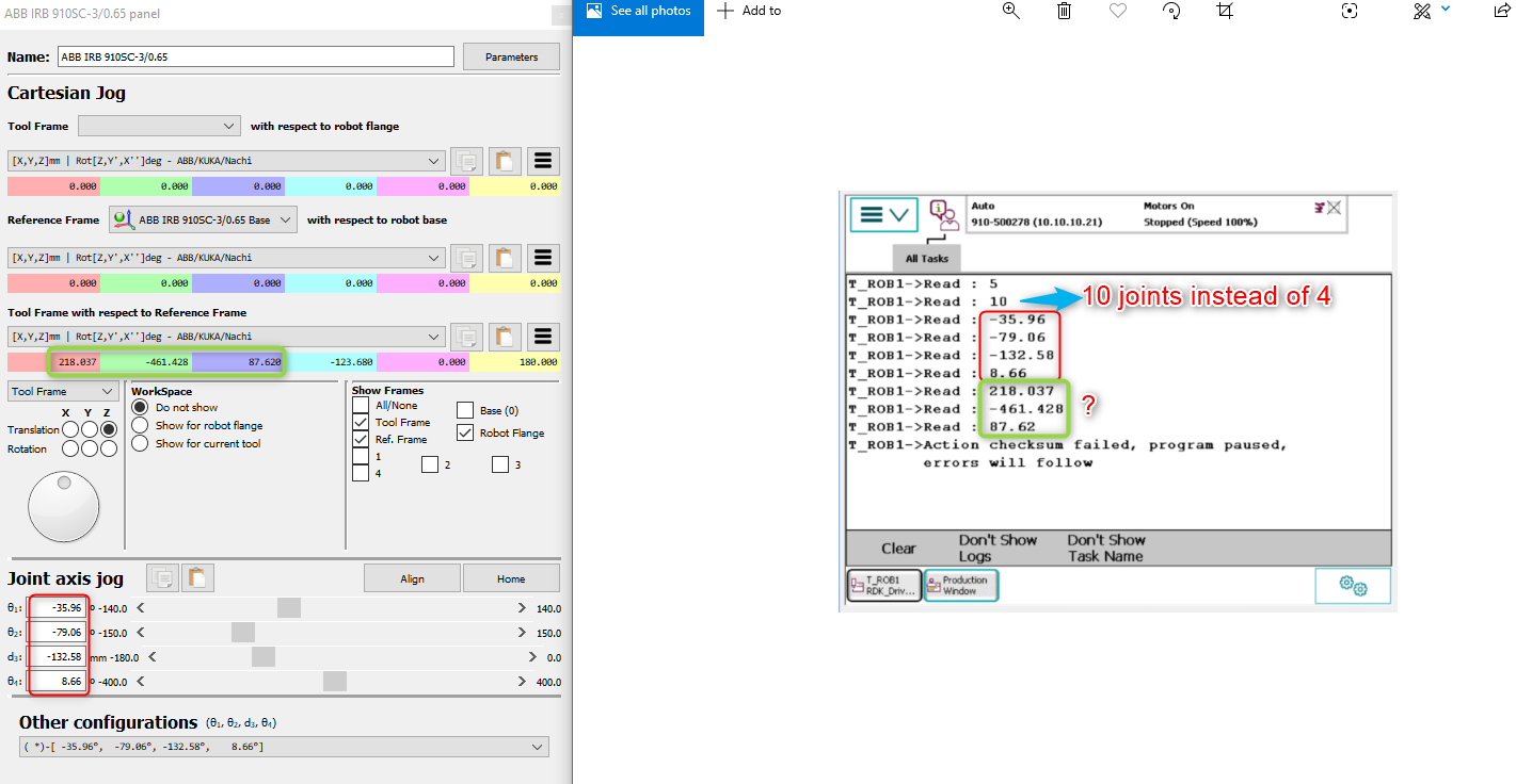

I'm trying to program online an ABB SCARA Robot (910-500278). I already run the module on the scara robot (Robotdk_Driver_Socket) and I got to connect with this one using RobotDK. As soon as I execute the first online movement, the module get stuck in the following message: "Action checksum failed, program paused, errors will follow". Image attached. Does anyone know why this is happening?
I didn't have any problems at all working with another ABB Robot (1200-800124).

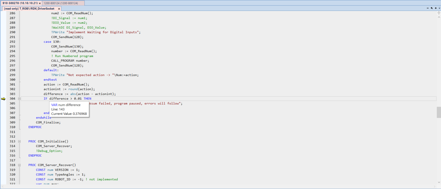

It seems the module is not able to recognize that the SCARA robot has 4 different joints (image attached).

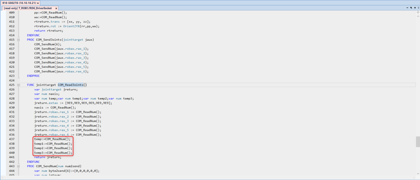

The problem was solved by adding 4 temporary variables at the end of the "COM_ReadJoints" function since there was a buffer that caused problems in the data communication process (image attached).
