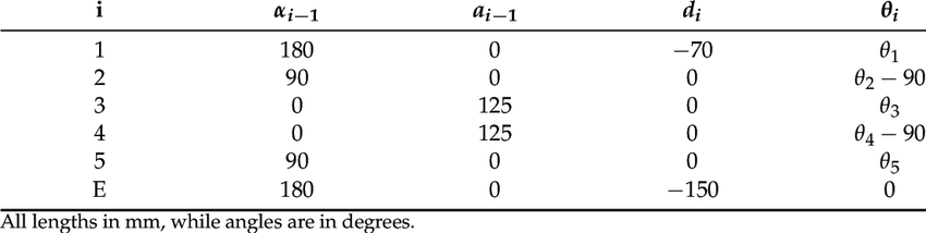

I am trying to setup the Braccio arm 6 DoF as a new robot using the "6 axis industrial" profile from the "model new mechanism or robot" tool.
I have got close, but some rotations are misaligned. It seems this could be due to the offset/rotation of the axis.
Attached is the CAD of the Braccio. I ended up saving each axis individually files in attachments.
Attached is the full CAD from ufactory and the individual STEP files I saved out.
Please could someone offer some advice on how to add the model to RoboDK.
Thank you in advance,
/Herve
