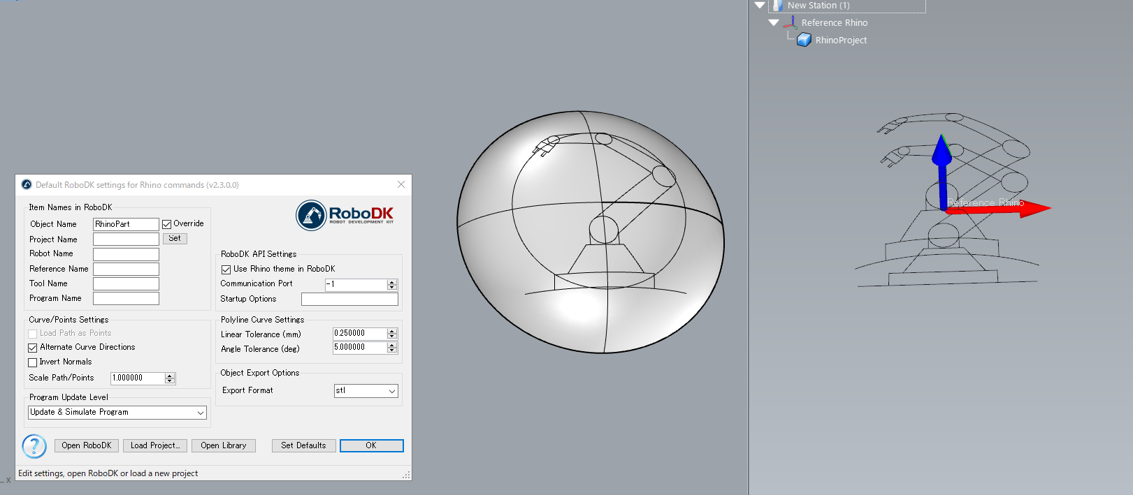

I am trying to export a 3d object according to the manual using RoboDK Add-In for Rhino,curve can be exported but mesh can't.
How can I solve it?

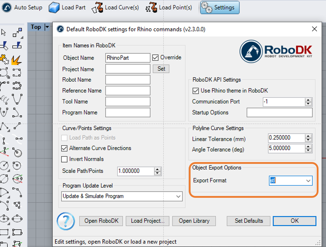

Can you try something quickly?
Try changing the "Export format" to "stl" and see if it works.

Hi Jeremy,
I tried, but the results are the same.

Hi Otani,
We are unable to reproduce this issue.
What version of Rhino are you using?
Did you try the Load Part or Auto Setup commands?
After re-installing Rhino6, it worked fine.
Thank you!
(05-28-2020, 07:32 AM)Otani Wrote: After re-installing Rhino6, it worked fine.
Thank you!
It doesn't work in Japanese ver Rhino6, but it works in English ver.
