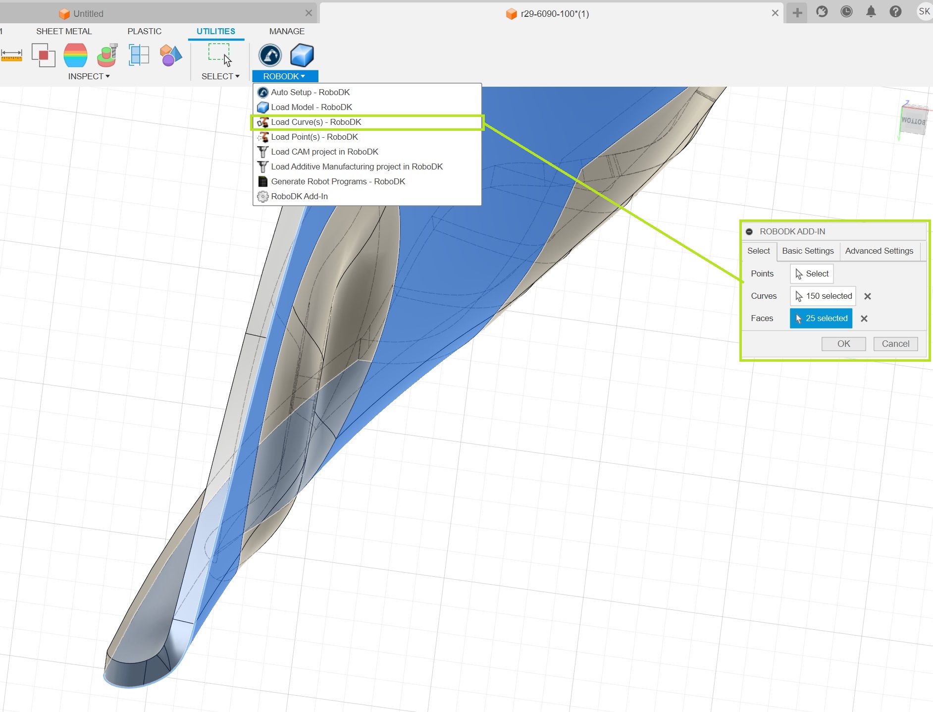

I'm just learning RoboDK and I'm added curves and their nominal faces using Fusion360, but when I import the selected point/curves I see I missed some of the curves.
How can I add those to the currect trim path?

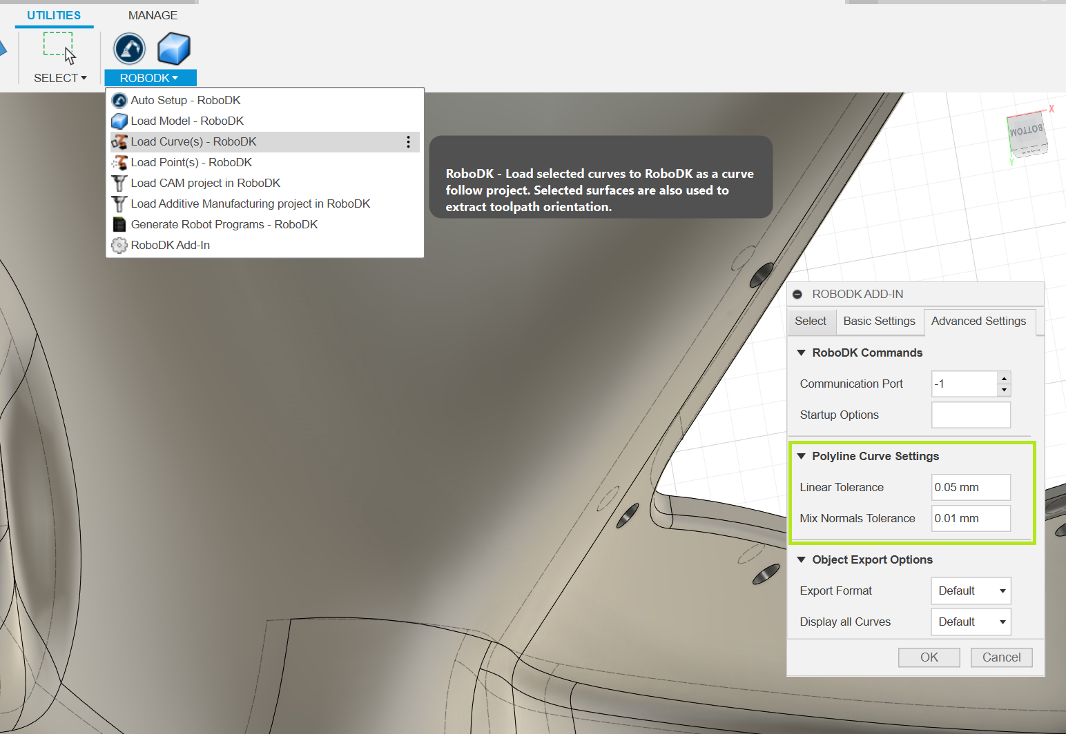

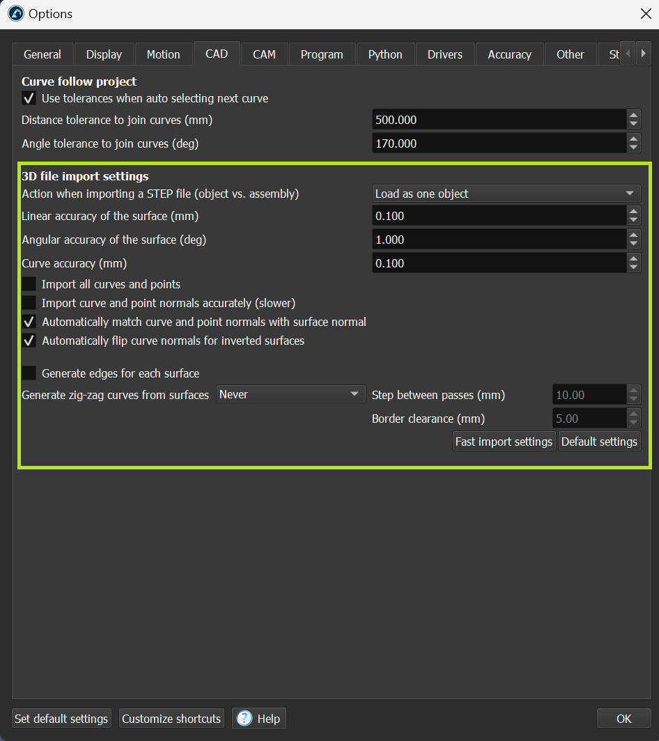

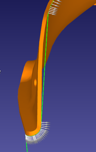

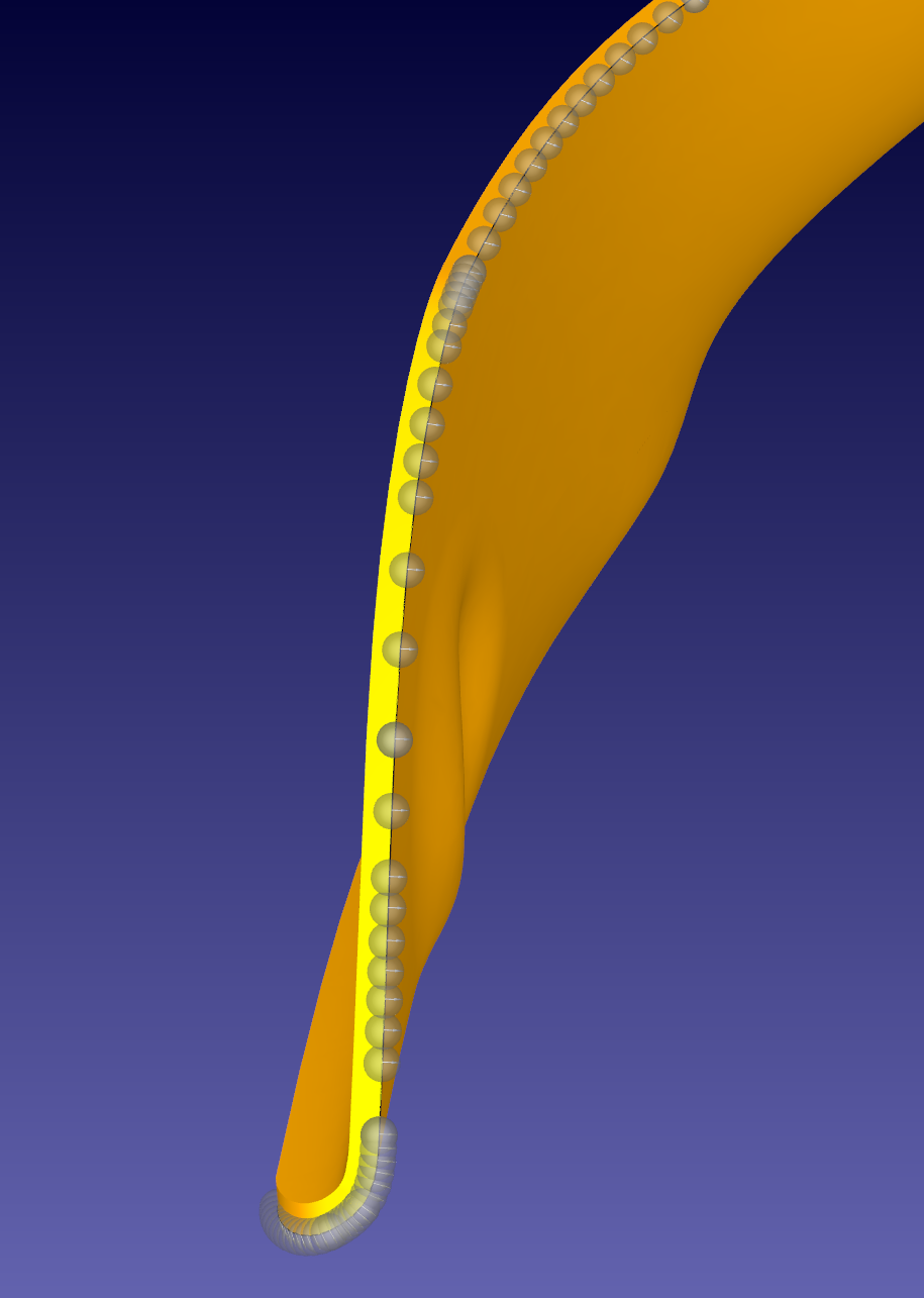

Your model has quite complex geometry, so to import the part and curve into RoboDK from Fusion360, I changed the settings to high precision values. Please take a look at the screenshots with the corresponding settings and station:
.rdk   import_f360.rdk (Size: 1.05 MB / Downloads: 504)
