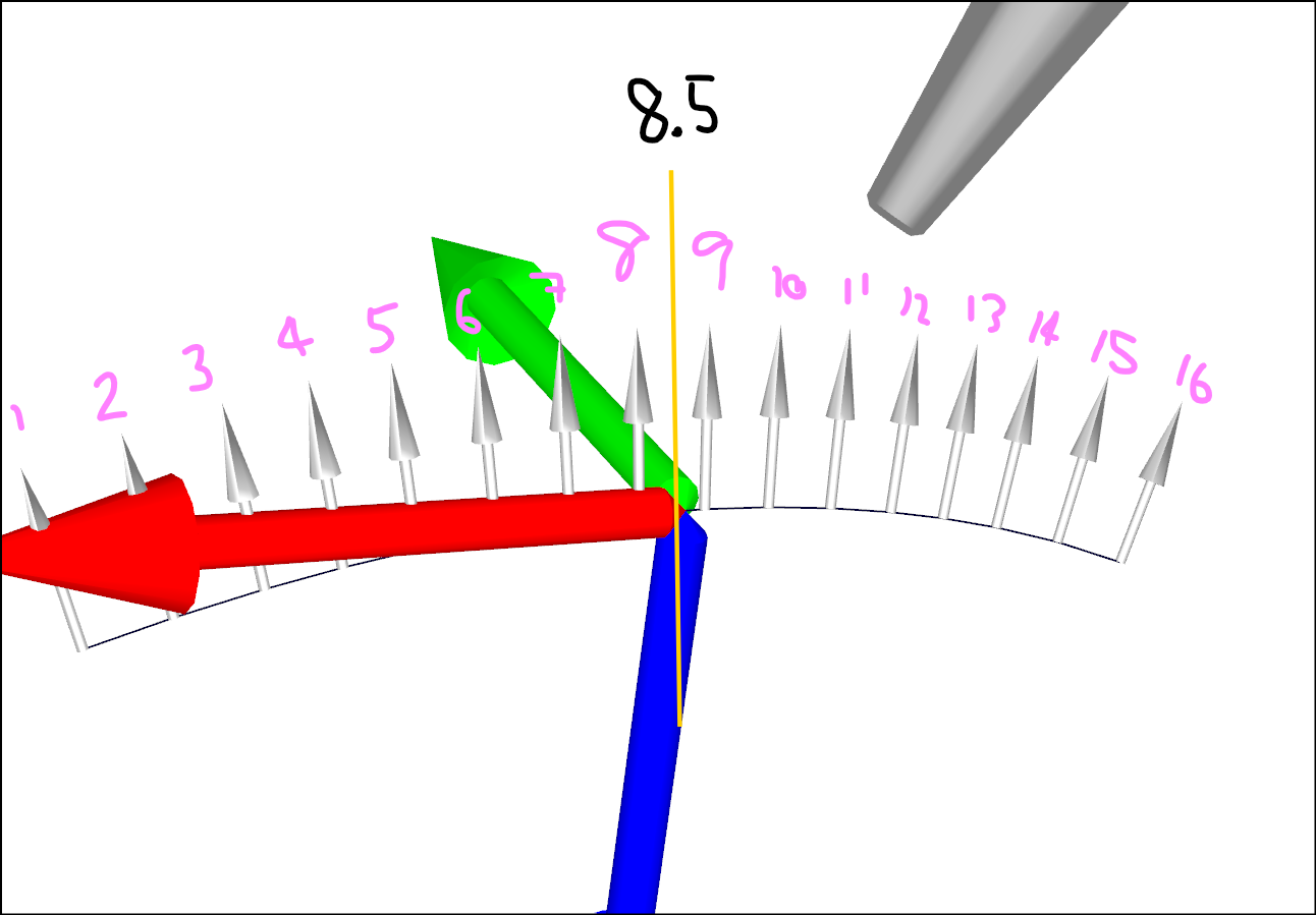

I have an issue where the curve-follow project's program is adding an additional linear move between the points that define the curve.
For example, we have a curve defined by 16 points. However, the linear move targets along the curve include 17 distinct points. Why is the additional target, between points 8 and 9, being added?
Additional move between real points 8 and 9:
