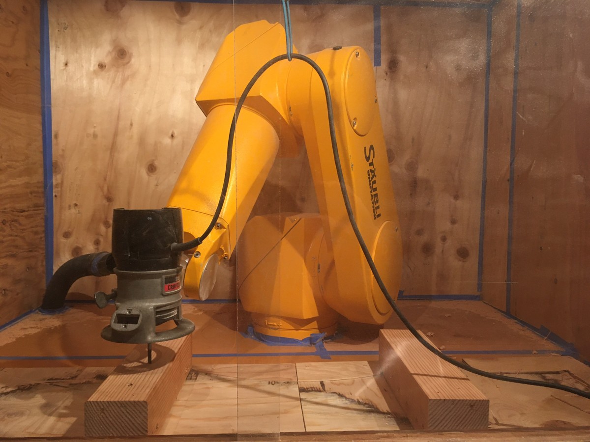

Looking forward to showing you what I plan to make with this wonderful software.  Here's a snapshot of my 1994 Staubli Rx90.
Thanks to you and Jeremey for sorting this out for me!

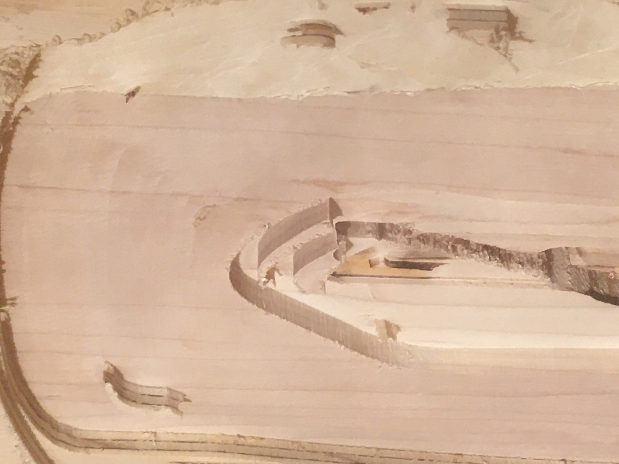

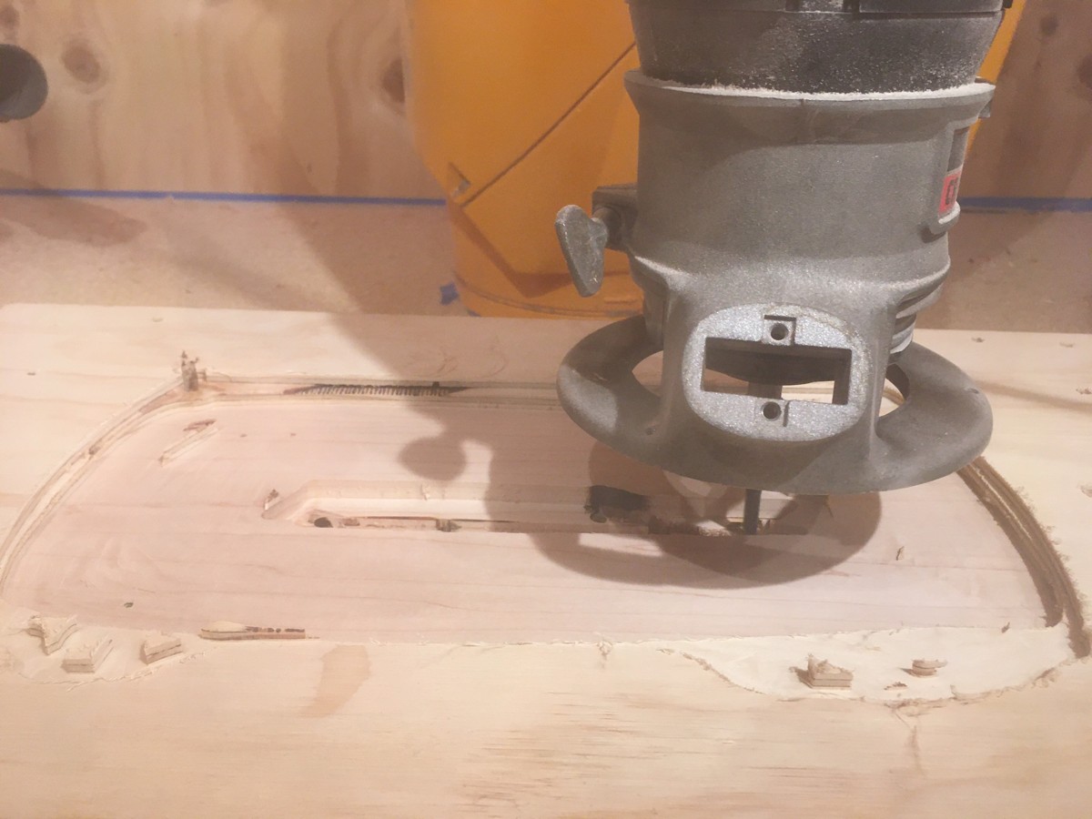

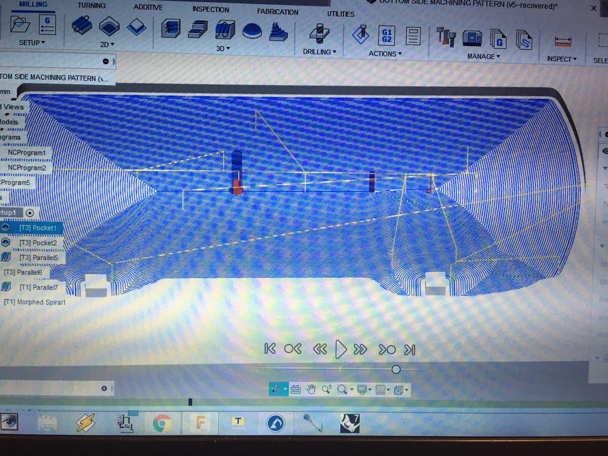

I am giving the machining a try now, and running into an interesting problem.  I've imported an nc file from Fusion to Robodk (maybe I should try another file format?).  The fusion simulation looks perfect - the first 7mm deep cut looks like a long spiral in the shape of an irregular rectangle, with a small, consistent overlap of 1.5mm.
Robodk also appears to have the correct path drawn in the 3d interface, and described in the simulation.
However, once the robot begins cutting the path, it clearly has a mind of it's own.  It is a bit erratic - sometimes following the path described, at other times acting a bit like a pinball machine, taking diagonal paths across the space, bouncing around, with a lot of tool time not actually cutting.  Unfortunately, this pinball-like-path, while mostly functional, removed two importand chunks of plywood that were meant to be left, as a result of un-planned diagonal cuts.  There are also some small areas of wood left over where the path did not intersect them.
This is also a problem for me because I don't want to stress the robot or router too much, and was not planning on having more than a 1.5 mm overlap for most of the cutting.  Quite often, the overlap is a full 1/4", ploughing straight through areas it was supposed to be gently trimming.
Could this have to do with the tolerance settings for joint singularities?  I don't think I've played with those and believe they are at their defaults.
I'm using a 1/4" carbide cutter, and have tried this with my tcp calibrated, as well as non-calibrated.  I don't see any difference in the path.  Photos and station attached for clarification.
Do you folks have any idea I could try for getting a path that remains closer to the one simulated?  Despite the fact that I am having some hiccups, I am really enjoying learning to do this work.  This is the first time I've attempted to mill anything substantial with the robot.  :)

Hi Jeremy,
The first time it is obviously taking an unplanned shortcut is around step 255-265 (according to the staubli controller).
One pattern I noticed - the left side of the machined pattern has VERY small step-over.  Maybe 1.3 or 1.5mm.  (good for me)  The right side (as shown in photos) has step-over ranging from 5mm to 10mm!
What do you think could be causing this unbalanaced step-over?
Maybe it's a calibration issue, but I still don't think it explains why the path is so different from what was plotted in fusion.  It appears normal-ish for a bit, but it often will create a diagonal cut, cutting lots of air, and leaving some areas un-milled.
Attached is what I sent to the controller (selkie.v2)  I renamed to .txt and removed the latter 3/4 of the program so it would fit the .txt file size limit.

I may try playing with Fusion 360 some more / altering the settings and pehaps attach an led to the end of my router bit. Then run the programs without stock in the dark using time-lapse photography to see the path it takes. I don't know of any better way to simulate it.
I am wondering - does RoboDk alter the cartesian coordinates Fusion spits out? If it does, can I ask it not to do that, in an effort to preserve the path made by Fusion? It's ok if I have issues with singularities as I can work around those, but I am just wondering how to approach that problem (the pocket clearing path going all over the place).
The adaptive clearing, while much more time consuming to calculate, seems to be working better for me.
