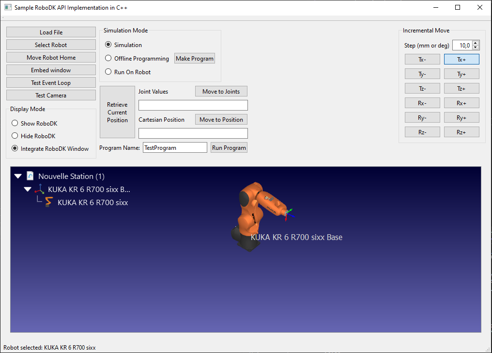

here is a copy screen of the example
With this example the behaviour is similar to my application.
If you try to change the view without clicking on button that's ok.
But not when you have clicked on action button...
The bugs I observed are:
  • Ask for a TX+ with 100 as step distance to have to click on the scene or ask for several TX+ (or any other)
when you click on the scene during the movement of robot the whole application will freeze.
In this example I just import a kuka robot.

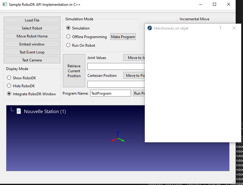

void MainWindow::on_btnLoadFile_clicked() {
    if (!Check_RoboDK()){ return; }
    QStringList files = QFileDialog::getOpenFileNames(this, tr("Open one or more files with RoboDK"));
    foreach (QString file, files){
        qDebug() << "Loading: " << file;
        RDK->AddFile(file);
    if (!Check_Robot()){
        Select_Robot();
when the function is called the application freezes

This is a known issue with some setups. I'm unable to reprodcue it using Windows and Qt 5.15.
This issue happens when RoboDK needs to pop up a new window. As a workaround you could implement this window in Qt and letting the user choose among available items on your end.
(05-21-2024, 09:12 AM)Albert Wrote: This is a known issue with some setups. I'm unable to reprodcue it using Windows and Qt 5.15.
Thank you Albert for your feedback. I managed it as suggested and that's OK now for this problem.
