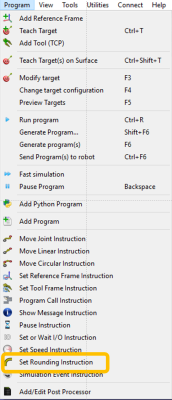

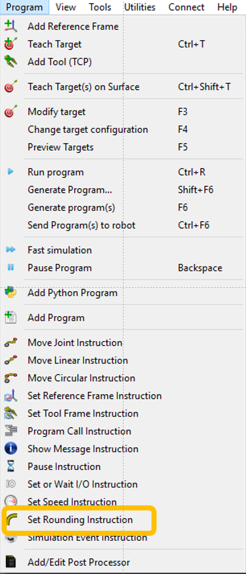

Hi eKoh95,
There are two ways of adding approximation points in RoboDK.
If you create a program, you can use the "Set rounding" instruction.
See picture below.

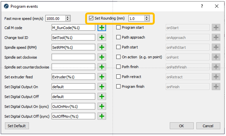

If you are using a Machining or Curve follow project, you can go in "Program Events" and activate the "Rounding" option.
See picture below.
Note that you won't see any difference in the RoboDK environment. Those "roundings" will be added, via the post processor, to the final script that you will send to the robot. Then it will be managed by the robot controller.
