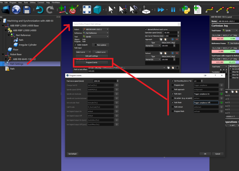

RoboDK takes care of programming the ideal path.
You can add any rotation or translation offsets to the path or the TCP to adjust for the real object and then use your Force control or Compliance hardware for other small surface irregularity adjustments.
Depending on the hardware you use, you can call a special function in the RoboDK Curve Follow Project to trigger your hardware compliance system at the beginning of the path, see the joined picture and station for example.
I also joined an .rdk station similar to your project.

I've just checked the file and it is exactly what I have in mind Olivier. Thanks for sharing.
