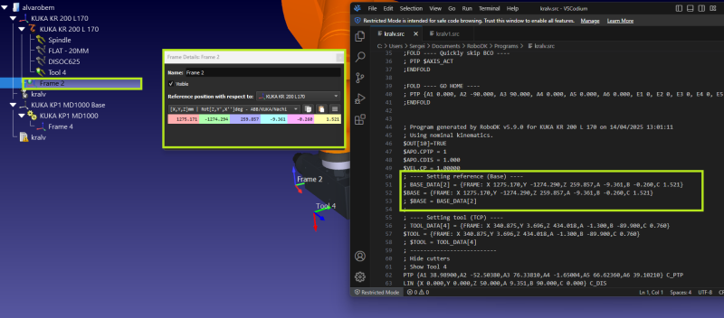

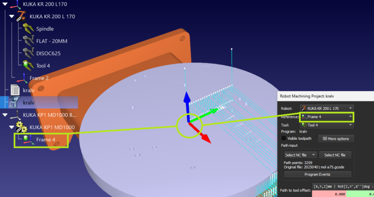

BASE question on kuka krc2 BAS(#ex_base1) instead of BASE=BASE_DATA[2]
I have a kuka krc2 and robodk for several time but dont work too much with it.
I have configured with sucess a turntable and it worked 2 years ago +/-.
Now i need to make a job without the turntable.
I created a fixed frame. Frame Number 2.
I use tool 4.
I already changed everything on post processor, tried the krc2 and krc4 without sucess.
The file produced generate every time :
BAS(#ex_BASE,1)
If i replace that line with $BASE =BASE_DATA[2] everything works good.
What i am doing wrong ?

You can customize the reference frame setting for the existing post-processor:
https://robodk.com/doc/en/Post-Processor...amesFilter
ok, it replace the code.
But same problem. The coordinates that use in the automatic code that it puts its wrong.
It is relative to the turntable.
It is not possible to mantain the turntable in the project and use the project to put coordinates from the fixed frame without use the turntable ?
When i remove the turntable from the projet everything is ok.
The problem is the turntable in the project.
Even if i put the fixed frame and the actrive reference the fixed instead of the turntable i get the problem.
Can i make something to correct this issue ?

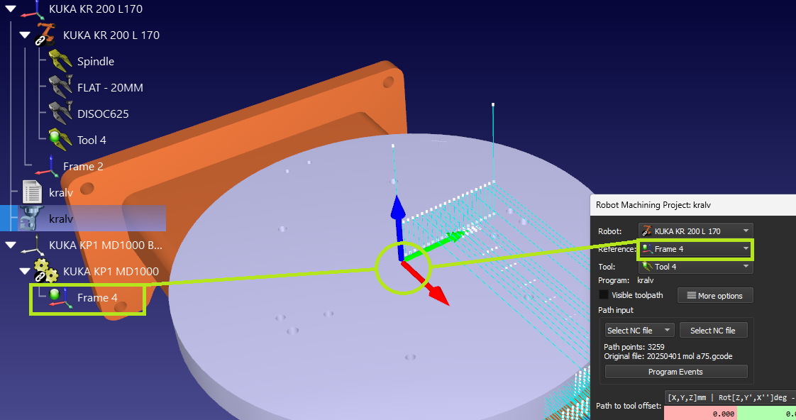

Have you tried removing the synchronization with the rotary table in the RDK station?
I modified your station a bit (attached): the rotary table is now unsynchronized, and Frame 2 is used for the machining project.
Does this work for you?
.rdk   alvarobem_md.rdk (Size: 1.24 MB / Downloads: 385)
That worked thank you.
Now i have another problem related to the base definition as well.
I am now using the rotary table.
The BAS comand does not work.
What worked is:
$BASE = EK (MACHINE_DEF[2].ROOT, MACHINE_DEF[2].MECH_TYPE, { X 26.930,Y 139.199,Z 0.000,A -152.400,B 0.000,C 0.000 })

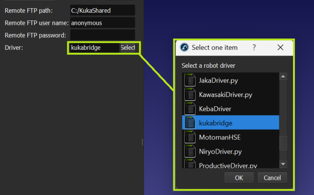

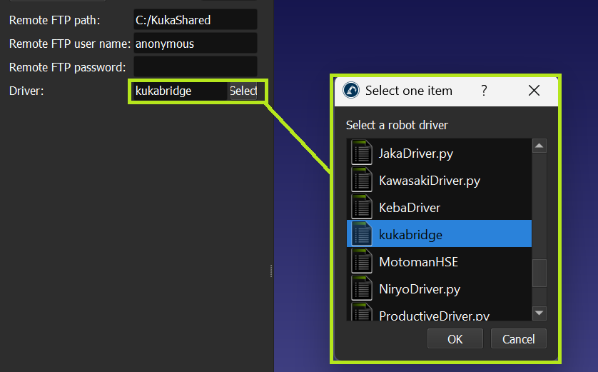

I guess you should try using the Kukabridge driver instead of kukavarproxy:

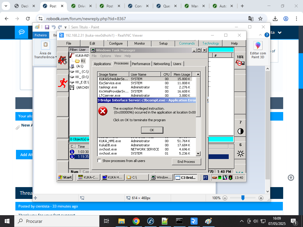

I already installed c3 bridge on kcp.
run the exe on kcp.

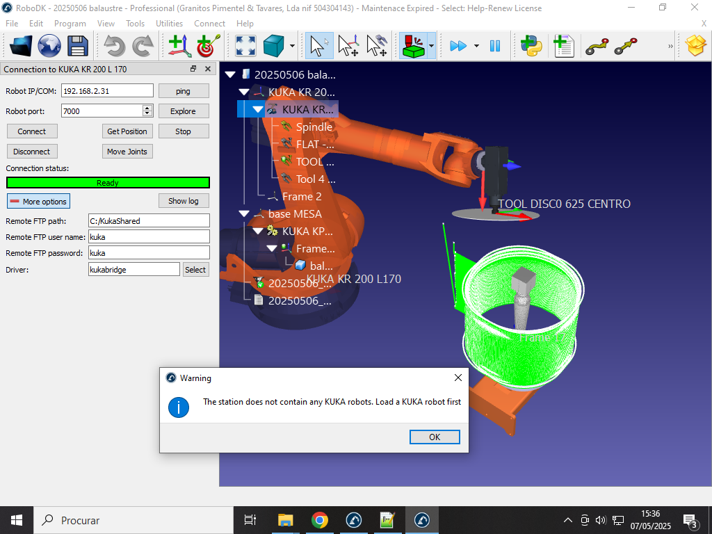

When i try to execute the script to autoconfigure it say i dont have any kuka robot in my station.
edit.

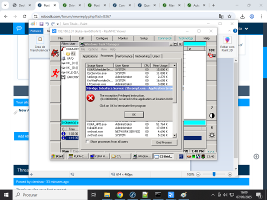

I try this:
https://robodk.com/doc/en/Robots-KUKA-Au...iverConfig
and when i execute configure force the kcp show error: c3 bridge interface serv ver c3bcompt interface error: the exception privileged instruction
0xc0000096
error

copy the robodksync562 to robot.
executed with the kukabridge driver and same problem.
The tool is defined as tool 1 and the base is not defined.
where i can correct ?

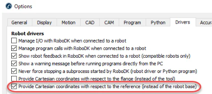

Could you please confirm that the 'Provide Cartesian coordinates with respect to the reference'  option is selected on the Tools - Options - Drivers tab?
Also, your program in RoboDK should use the same coordinate system you defined in your $BASE variable (the active reference).
