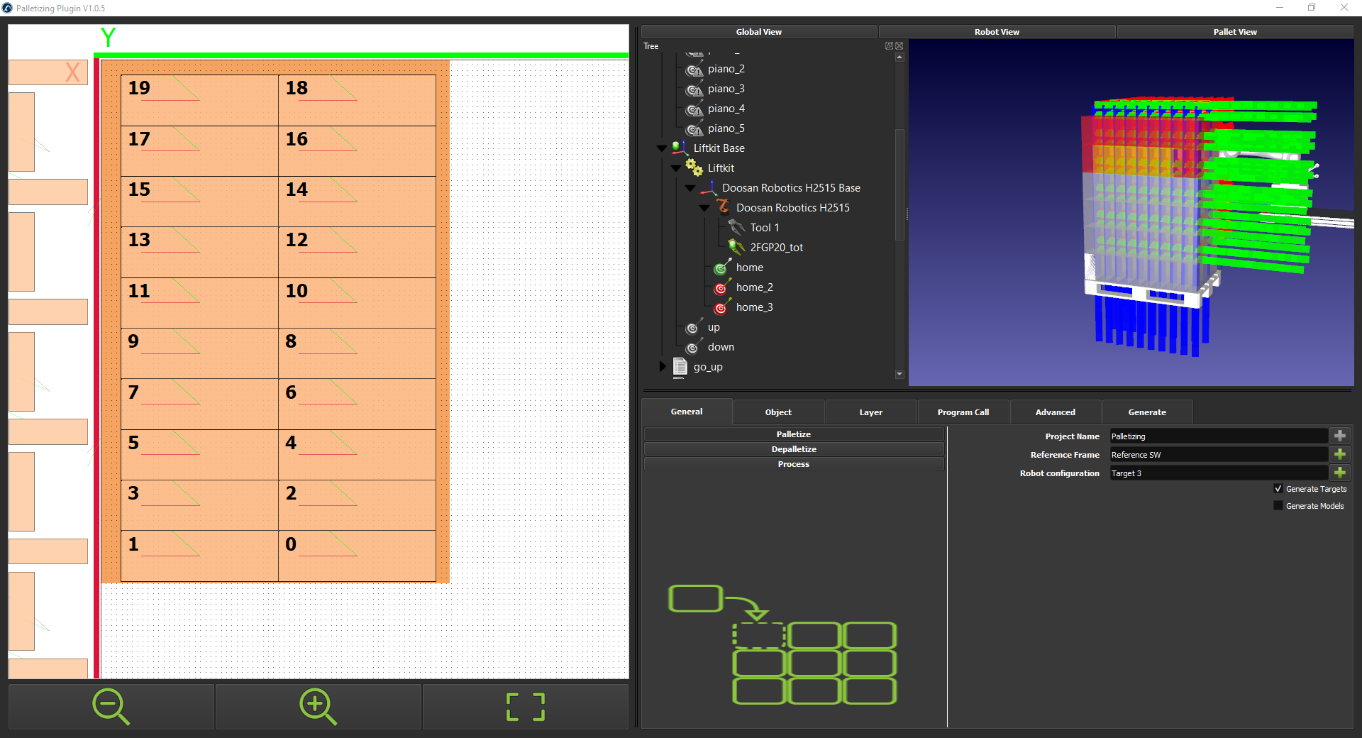

Hi Francesco,
Honestly, you should also delete the palletizing item from your station tree and create a new one.
I don't know how this happened but it looks like you used a version that was never supposed to be released.
I can tell by the way the red and green lines on the boxes are not perpendicular.
