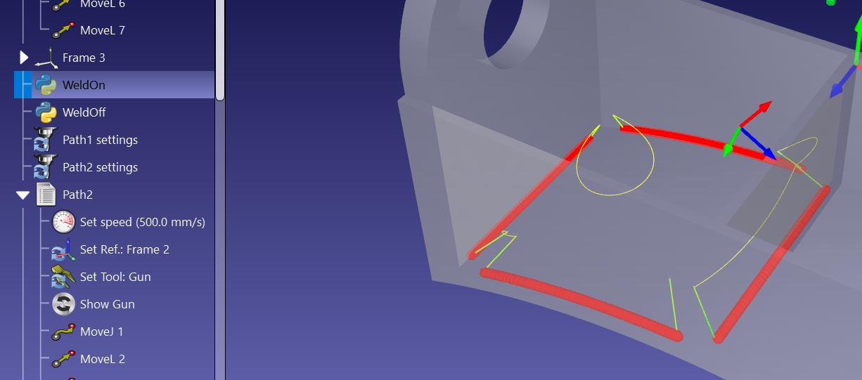

I use the Macro WeldOn to create the bead for welding simultion, and it works well.
But when I export the simulation, it seems that the bead created by Macro:WeldOn does not present in the simulation. Is there any way to show the bead in simulation?
Thank you.
Do you mean you exported a RoboDK for Web link, a 3D PDF or an HTML simulation? This material deposition effect is not supported when you export a simulation.
(03-09-2023, 06:17 PM)Albert Wrote: Do you mean you exported a RoboDK for Web link, a 3D PDF or an HTML simulation? This material deposition effect is not supported when you export a simulation.
Yes, it's a 3D PDF or an HTML simulation and I got your point. I will record the screen instead.
