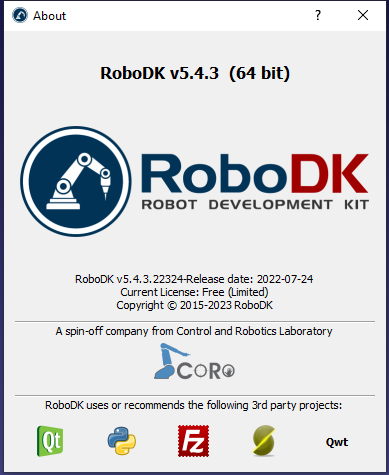

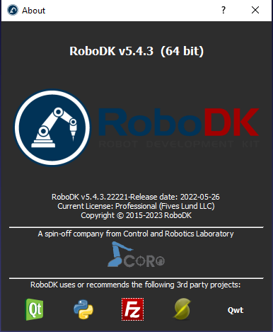

I did some more testing with the link to V5.4.3 that you provided. It looks like I am continuing to experience the same issue on my virtual machine even when using RoboDK 5.4.3. However, I noticed that the version of RoboDK on my physical machine is the build from 2022-05-26, while the link to the installer you shared seems to install the build from 2022-07-24. I have attached screenshots of the about for each version.
It looks like between those two versions, there was some change to the API. (2022-07-13: "Improved API") I suspect that this change may affect the instability that I am seeing. Do you still have a way to build the V5.4.3 version from 2022-05-26 that is working for me? I would like to attempt to install it on my virtual machine to attempt to narrow-down the issue.
