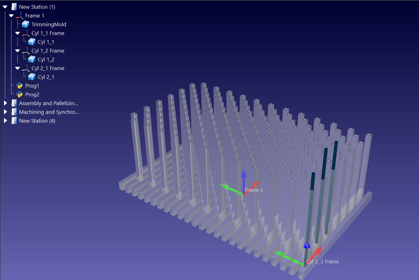

We are trying to model a machine with a large number of linear actuators. all actuators are parallel and move independently.
I does not need to be synchronized with the robot as it will be used mostly for collision detection
I haven't found a way to build a mechanism as such in robotDK so I thought of using a Python script to control it. Is there a better way?
A Python script is the best way to model an array of linear actuators like the one you are showing. I recommend you to use the function to update poses in bulk (setPoses):
RDK.setPoses(item_list, pose_list)
This will quickly and efficiently place all objects representing your axes with respect to the base object, provoking only one render event.
