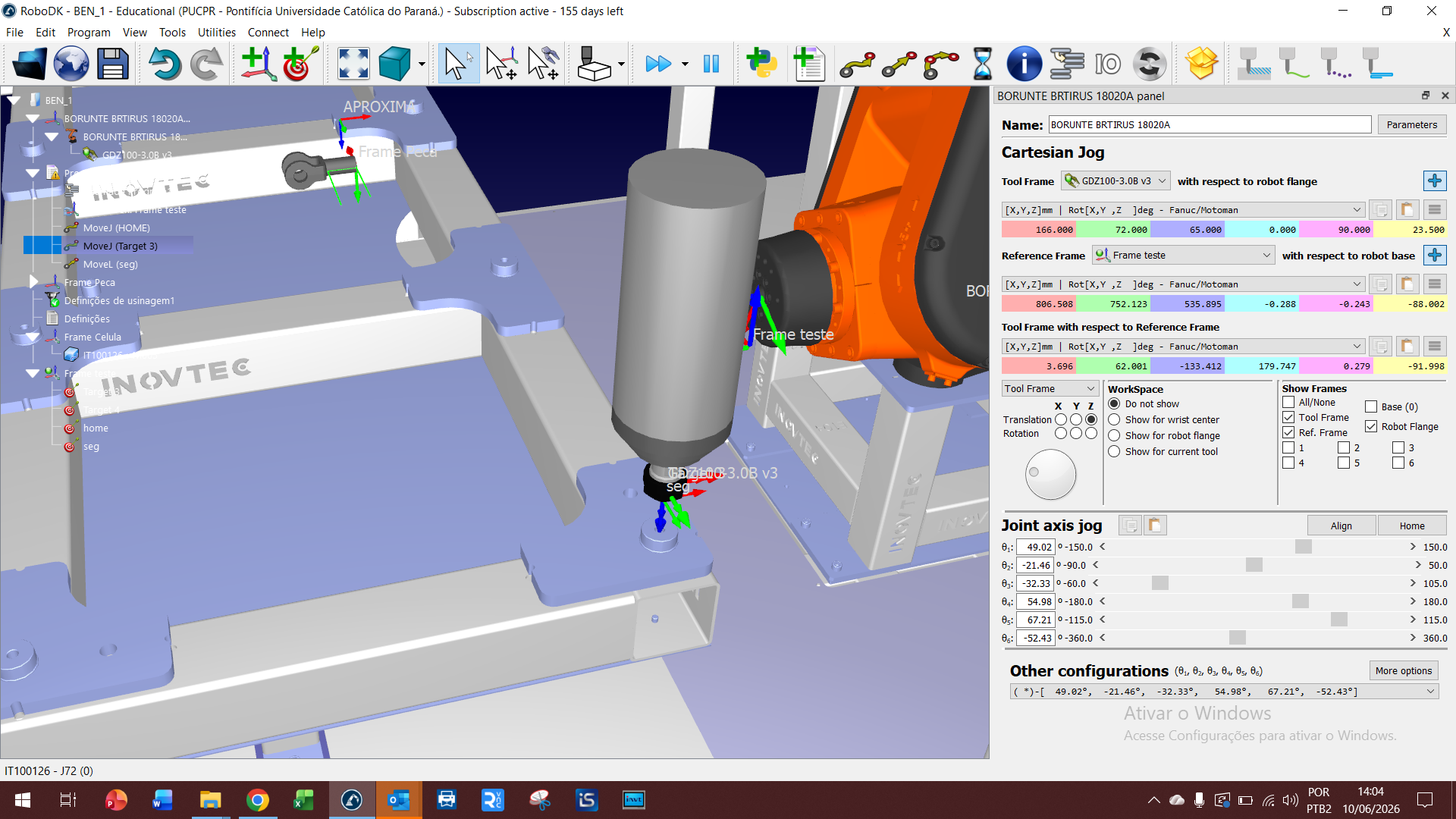

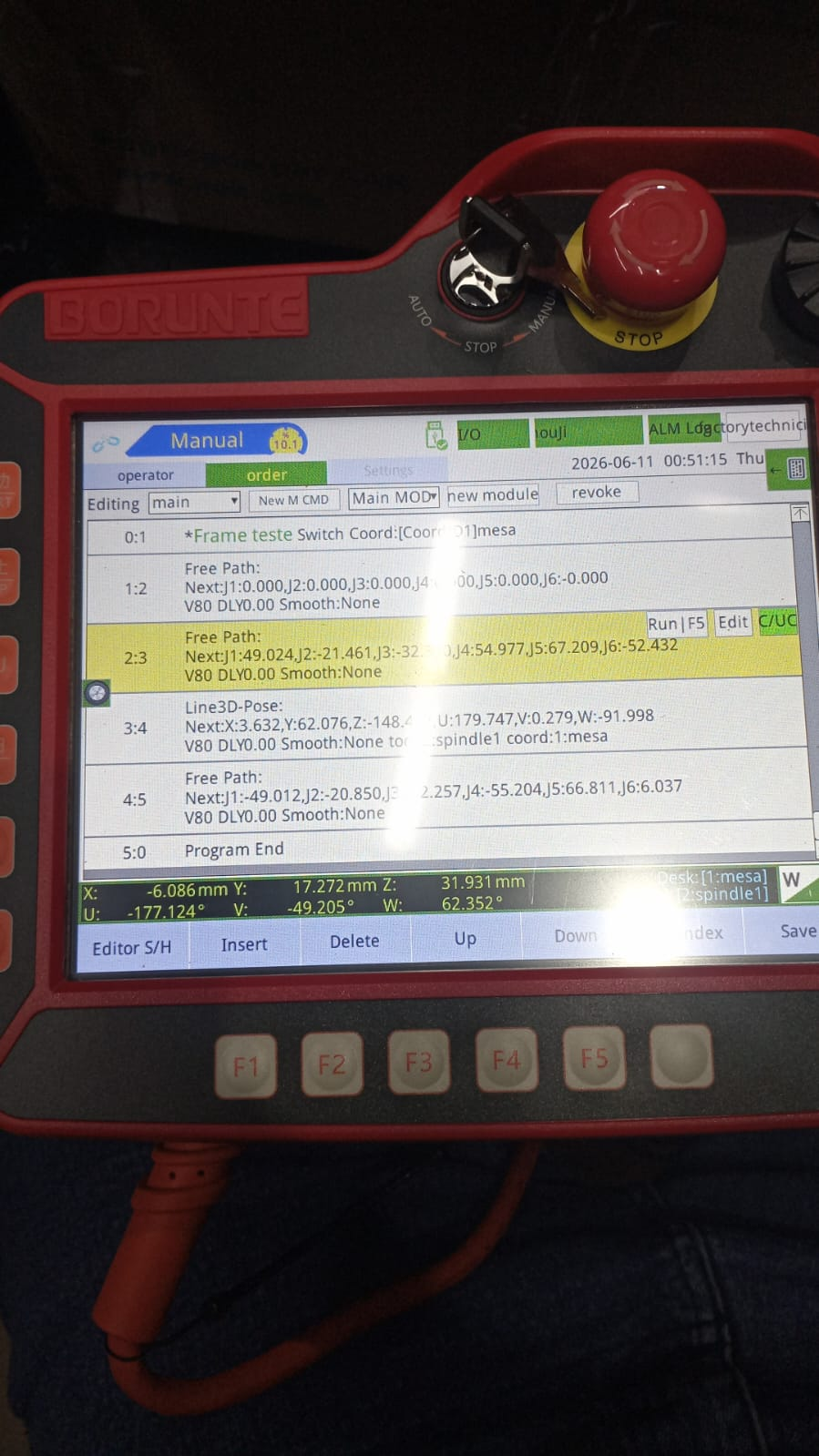

I made a base, TCP, I put it in the software, it gets close but not correctly...
And there's a big difference when linear movements. See the real position by the photo, standing still in that position.
It appears that the active TCPs on the real controller do not match those in RoboDK.
To investigate further, you can compare the flange coordinates when all joints are in the zero position.
This comparison should help determine if the physical robot has been mastered correctly.
