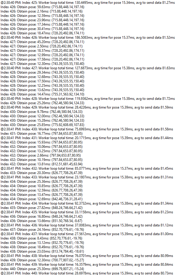

I will also include a log of some sorts from my real code (in which the robot is moving from inputs of a script). Lines without the @ are poses obtained, showing time and orientation information. Lines starting with @ are the data points sent showing total time to send the unique data point, an average times (for obtaining any pose versus a unique pose).

Edit: I noticed that when executing the script to move the robot that obtaining pose information decreases the average time per non-unique pose to 0.27ms on my machine (while also minimized sending messages to the log), far better than the 15.4ms times I've been getting. Just need it to work while the robots are moving as unique points ;)
