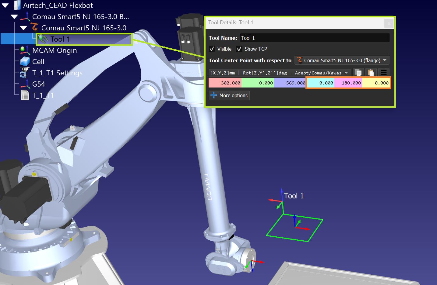

It is necessary to double-click on the corresponding tool item in the station tree and adjust the angles:
Thanks but nope,
I figured it out. Options>CAM>Invert Machine Tool Axis.
I was also missing that "Invert Machine Tool Axis" needs to be checked in the Robodk settings of the Mastercam plugin as well.
Thanks though!
