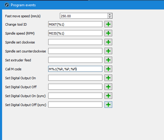

I'm trying to call the M codes from a .nc file. But I can't seem to get the M codes with the correct arguments.
This is what I have in my .NC file:
This is how I've configured RoboDK:
This is the result:
I would like to know if there is another method to configure RoboDK.

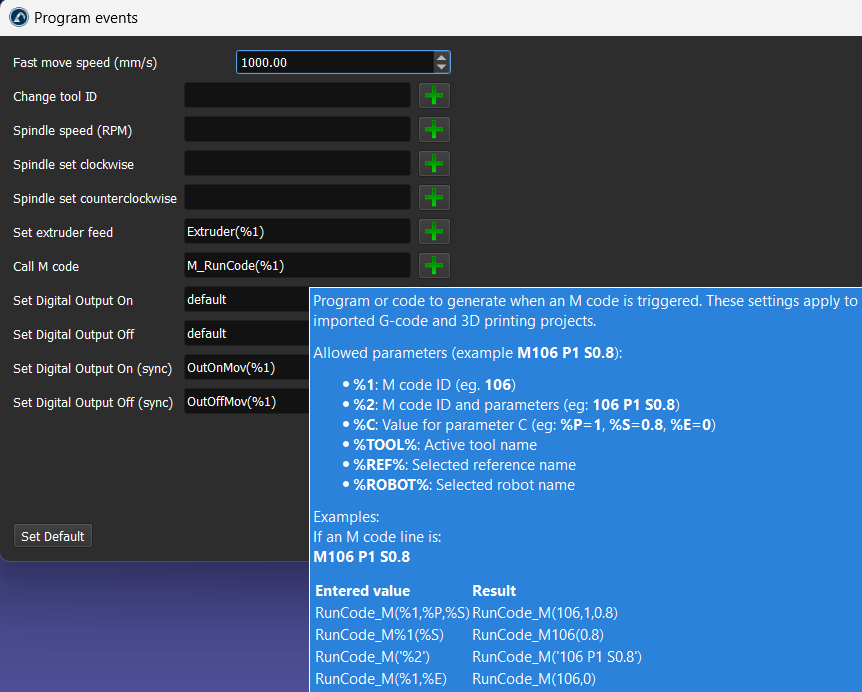

Supported parameters for M codes include C, P, S and E. I believe parameter R will be ignored.
You can find more information with the tool-tip when you are writing the M code. See the attached image.
Also, you may need to add spaces between each group of parameters.

05-27-2024, 12:03 PM
It supports the R, P, and F parameters, but when it doesn't find a parameter, it defaults to 0.
This results in M330(1,0,0) instead of M330(1) and M7(0,65,30) instead of M7(65,30).
