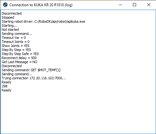

Here is the log from RoboDK. The temperature value, 298, is showing up there.
Can you try with the latest version of RoboDK?
It should provide the string back through the setParam function.
