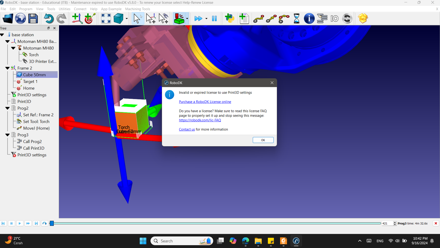

i just updated my robodk to the last version and I cant use some of projects on the utilities menu. it always says invalid or expired license. i know my license has not expired, it has hundreds days left.
could you give me solutions so I can still use the feature with my license?

Hello, any update about this problem? i still cant use 3D project menu. it still shows an invalid or expired license
Hello. i dont get any update about this this problem either in my email.
due to I cannot use the feature, so I wanna try reinstalling the old version robodk.
do you thing this is happening because i installed the current version roboDK? should go back reinstall old one to solve this problem?
It looks like this problem happens because you installed a newer version of RoboDK that is not supported by your license. You should be able to fix this issue by installing a previous version of RoboDK or by renewing your maintenance.
okay, i should renew maintenance.
i wanna make sure. if i purchase edu license, so i get a license for 2 yr subscription and 1 year of maintenance. in my case, I use the license 1 year and has 1 year left without maintenance (maintenance just covers the first year license). so, if I renew the maintenance, does it mean it will extend my edu license 1 year?
Renewing the educational license will give you another 2 years. Please note that the educational license should be used for educational purposes. You can find more information here:
