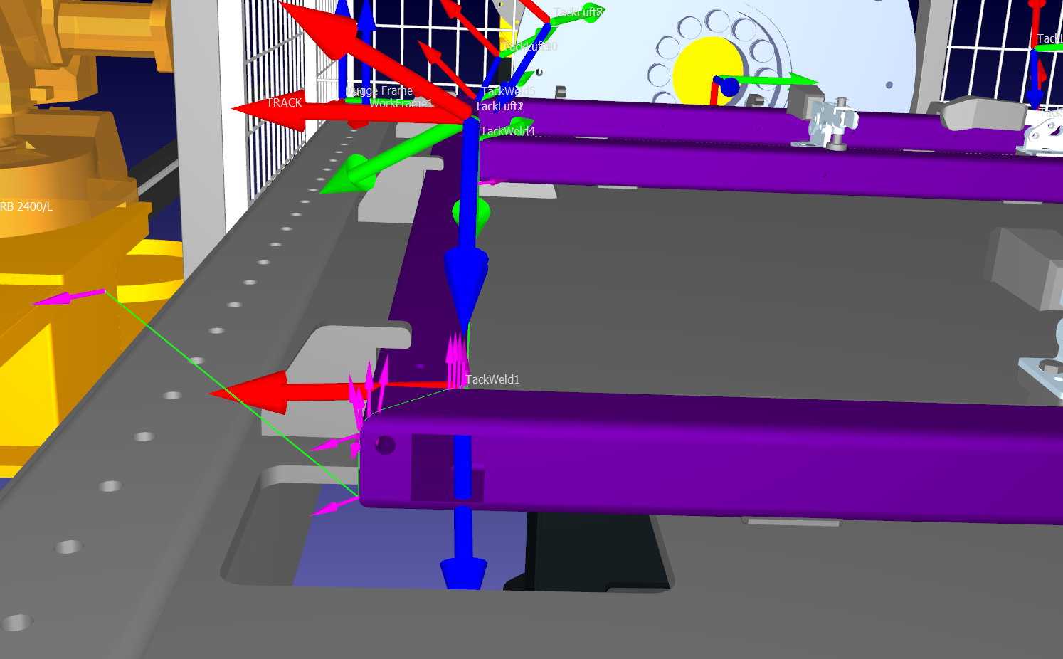

Okay, it might just be me, but i cannot figure out what im doing wrong here.
When i try to modify a curve, the normals do not want to move like illustrated in various videos on the subject.
Can someone tell me how i make the normals move?
as you can see on the screenshot and the video they are all over the place

You will help if you make the coordinate systems and normals smaller. You can do so by pressing the minus (-) sign multiple times.
We'll look into improving this feature in the future so that other normals do not interfere.
Allright, i have tried that, but that does not help, they still wont move around.
should i be pressing a button to make them move or something?
No, just press the minus key (-) until they are small enough so that other spheres do not interfere with the sphere you want to manipulate.

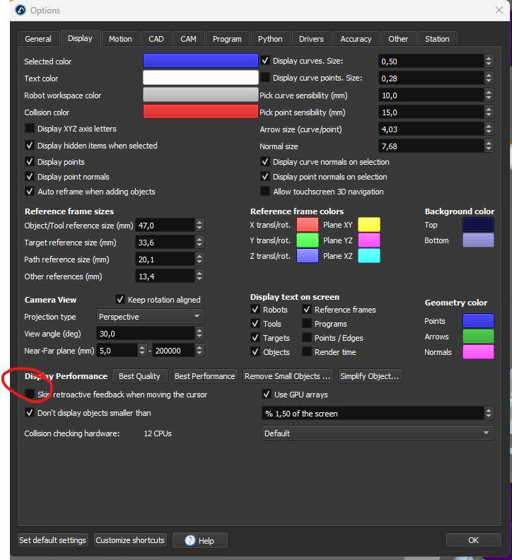

Allright, now I figured it out :)
I had tried to make the arrows smaller by pressing (-), but that did not move them around on my screen.
Pretty frustrated, i startet disabling add-inns one by one, to see if that had any effect, still no.
Then i startet to go over my display settings, and finanally figures that the "Skip retroactive feedback then moving the cursor" was enabled.
unticked it, and viola, worls like a charm now :)
But yes, the inteferring of the arrows is a problem on the long run, and would be nice if it was fixed :)
But now i can move on, and complete my simulation :)
Thanks a lot for the help, the confirmation that you could make it work, convinced me that it was my settings that was the problem, and eventually solved the issue :)
