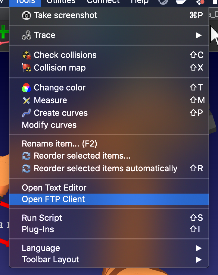

Can't find Tools-Options on Mac
I'm trying to troubeshoot the python interpreter on Mac, but can't find the 'Options' That's supposed to be in the drop down menu of Tools. Attached is what I see when I select tools.
Any help would be appreciated.

Hi there,
I'm not familiar with MAC, but on windows, you can access the "Options" by pressing "shift + o".
Maybe that can help.

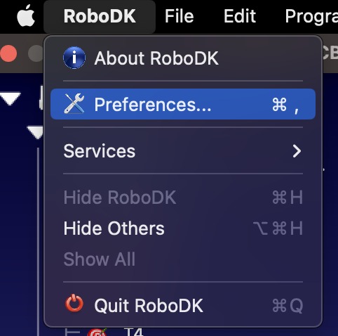

Hi there,
I found the Option should locate in "RoboDK--> Preferences"
