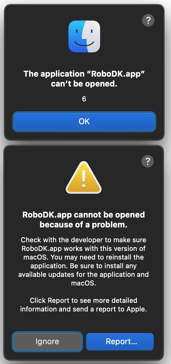

Thanks for the reply. Here is a screen capture of the errors I see.

Sorry, I didn't get a notice of your reply.  I tried reinstalling and still get the same results.  Below are the details:
