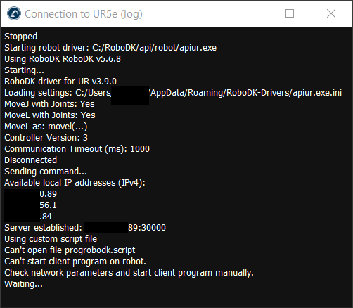

Hey Alex,
Yes I will attach below the log output, it may have something to do with the "progrobodk.script" file not opening but I am not sure what that means. Also, yes I am connected directly to the robot from my PC and have configured the ethernet connection properly (same subnet).
You should delete this file:
C:/RoboDK/bin/progrobodk.script
This will use the default script which should work on any UR e-series robot.
(12-29-2023, 04:30 PM)Albert Wrote: You should delete this file:
This worked, thanks!
