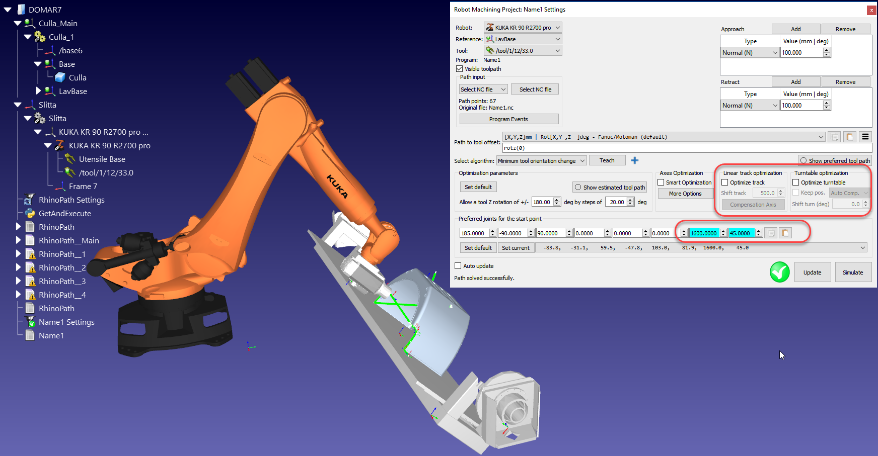

You should make sure you specify how you want the external axes to behave:
  • Fixed external axes: the turntable or the linear rail will not move and will remain static in the "preferred joints for the start point". You have to enter these values so that the robot can reach your path. See the 2 blue boxes in the attached image. If you load the Name1.nc toolpath, it is feasible with the rail set at 1800 mm and the turntable set to 45 deg.
  • Optimized external axes: you can activate the Optimization options to move the rail or the turntable according to certain criteria (for example, if you activate it for the rail it will keep robot axis 1 constant and move the rail instead).
  • Smart optimization: this option has been added recently and allows you to define priority "weights" on each axis. This will alter the default optimization.
