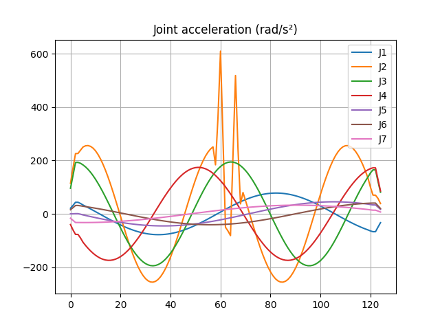

[Image: joint_acc.png]
Observation: J2 axis experiences a massive acceleration spike (>600rad/s2) near frame 60.

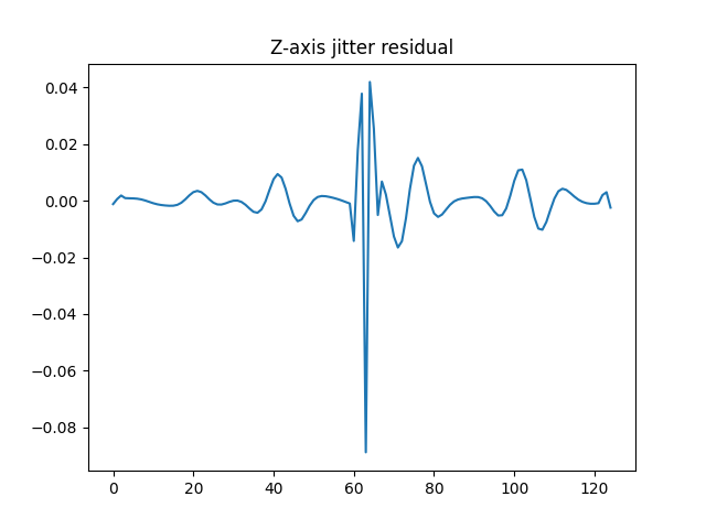

[Image: z_jitter.png]
Observation: High-frequency jitter in the Z-axis exceeds 10 mm,indicating potential solver instability.

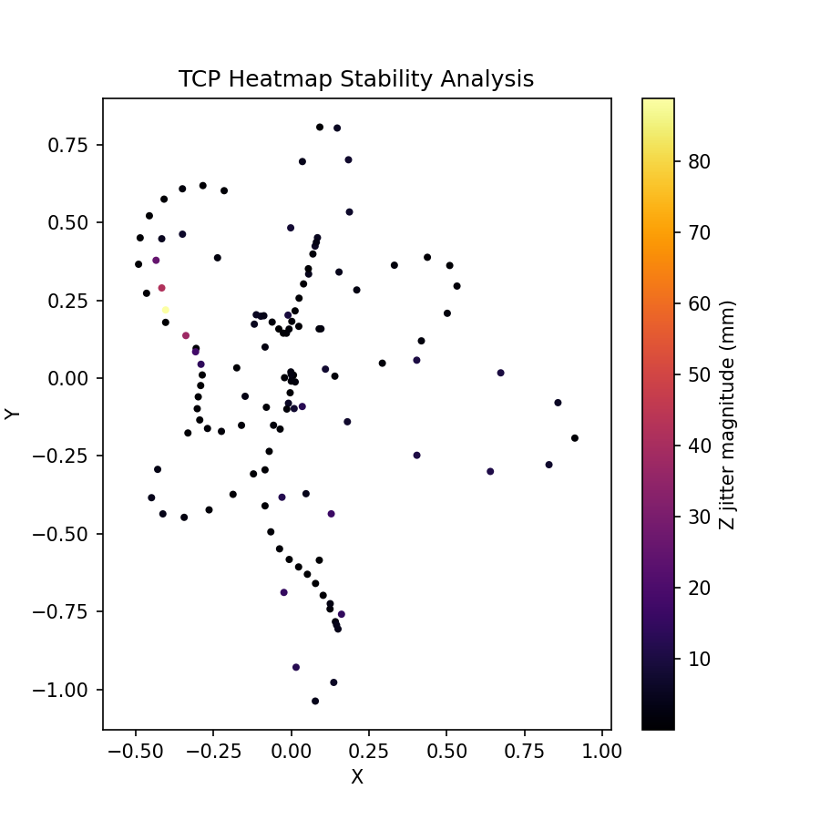

[Image: tcp_heatmap.png]
Observation: Yellow/Pink clusters indicate localized instability zones in the working envelope.

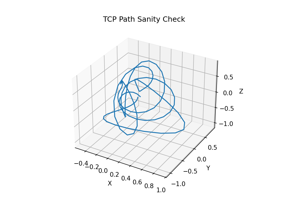

[Image: tcp_3d_path.png]
Observation: The 3D path shows geometric continuity, but hides the underlying physical jitter.

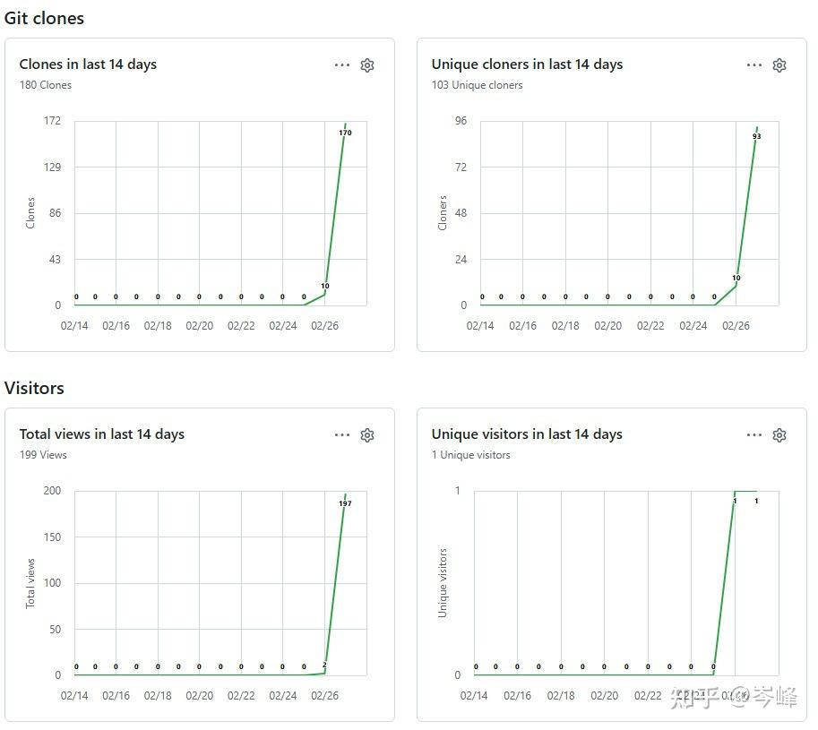

BTW, an interesting observation: Since I released SIPA, I have noticed a massive surge in "stealth" traffic—clones performed directly via command lines rather than browser visits. To me, this indicates that engineers within major industrial and research clusters are already evaluating these "physics consistency" gaps internally, likely behind corporate firewalls. [Image: v2-5a7098dc3b03538ab1cb1e6d33e06671_1440w.jpg].
This confirms my view: the industry is silently suffering from these numerical artifacts, and there is an urgent, unspoken demand for an independent audit standard.

P.S. The attachment is the recent traffic statistics of the SIPA warehouse. I believe that instead of letting such auditing needs grow silently “behind the firewall”,RoboDK should take the initiative to standardize them and establish a leading position.
