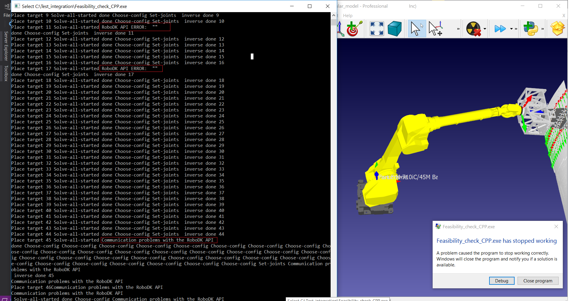

 And summery of the results after many tries:
As it can be seen, after 9th target it cannot communicate, therefore no configuration is desirable and then it goes to target 10 and 11 with dragging the problem and finally it crashes.

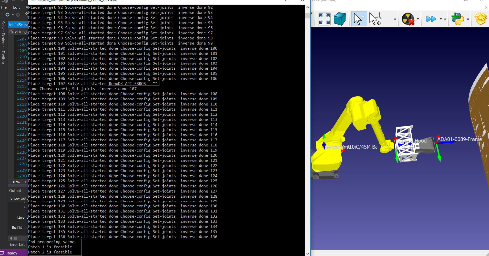

here,
the error shows up after target 107 once and after that everything works and finally with no problem the code continues.

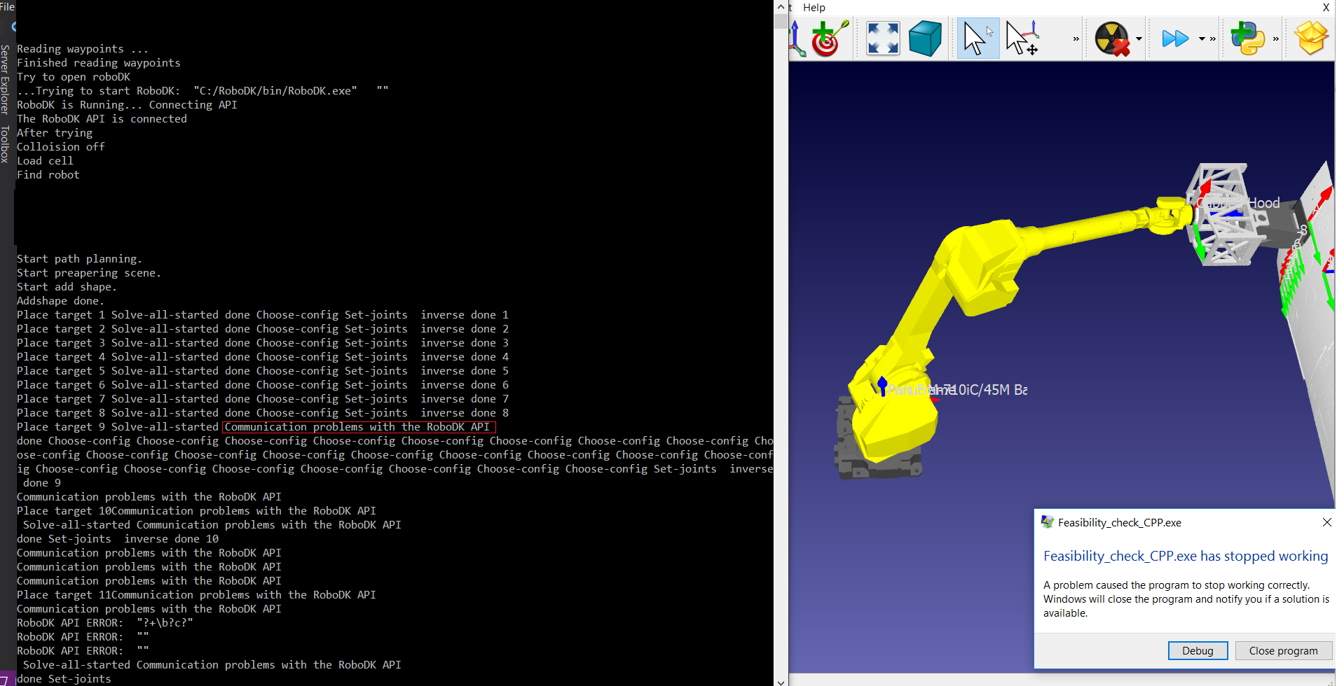

here,
the error shows up after 11 and 17 and not problem all the way to 45 that it crashes!
As it can be seen, the problem happens after "Solve-all-started" and before "done".
Do you have any idea why this is happening?
