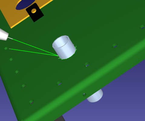

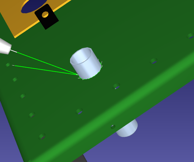

Hi, is it possible to get the "curve follow project" to use moveC when creating complete circular movements?
I have done it using the existing "curve follow project", and that is working fine, but the programs get so long because of all the moveL movement.
I'm going to weld pipes and fittings to a steel plate. See picture.
Unfortunately now, the CFP doesn't support move c for the moment.
