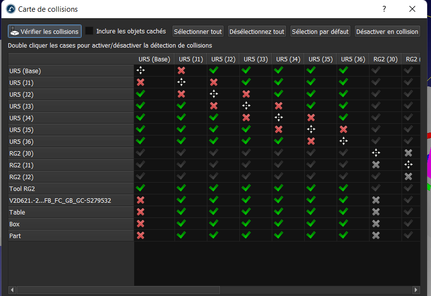

First you have to identify collision (Activate check collision and look for red elements in your scene).
Next you can disable collision between irrelevant part or mounted parts like Tool/Robot, you can do so by clicking on (Shift + X) to open the collision matrix (Attached in the image) , identify your colliding objects and disable collision for that exact couple.
