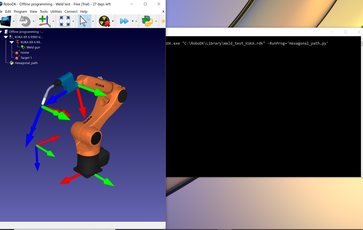

Hello Albert,
I am very new in RoboDK.
I try to open script example of offline programming from CMD, using your solution (-RunProg='file.name'), but unfortunately I can not open the script. Only project contains the script is opening.
I attached 2 screens: 1 - is full command in CMD (my Working Directory = C:\RoboDK\bin),
2 - output that i get (just opened project "Weld_test_KUKA.rdk", but not hexagonal_path.py").
Do you have any idea how can I fix it?
Thanks a lot in advance!
Best regards,
Oleg

Hi Oleg,
To run a program you should simply have the name of the program or the python file without the extension.
Example:
RoboDK.exe project-file.rdk -RunProg=Hexagonal_path
(08-13-2020, 01:51 PM)Albert Wrote: Hi Oleg,
Example:
Hi Albert,
Thanks a lot for quick help!
All the best,
Oleg
