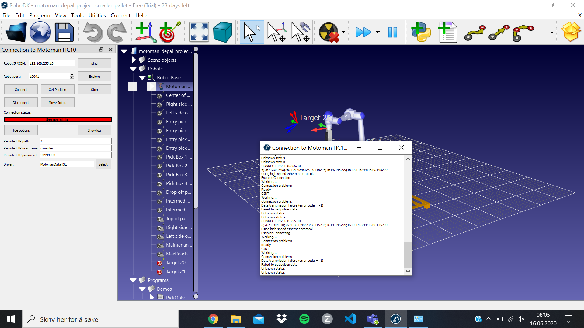

I am trying to connect an Yaskawa HC10 with an yrc1000 controller to robodk but it does not work properly. It does ping and connect, but as I try to either get its position or move it gets connection errors and says unknown state. I have attached a screenshot including the log.
I have seen similar threads and tried disabling the firewall and other tricks without any luck.
